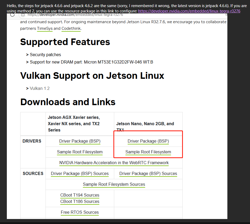

Thanks @WayneWWW for that, its makes so much sense, after i tried plenty of sd images without sucess…
trying to get more details of the board flashing process on waveshare

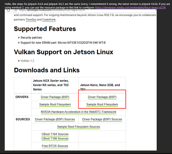

Got answer with working solution from Waveshare, Just follow instructions on image, tested and working.
Hope this will help other developers experiencing same issue,
