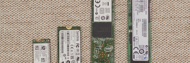

After some research I have determined that the choice of M.2 Key B was a poor choice for the development board. Unfortunately there are several incompatible M.2 standards:
http://www.mouser.com/pdfdocs/M2ConnectorBrochure201412181.PDF
The DEV board contains an “A/E” key. This is only supported by a few WiFi Cards, which are of very little value. The LTE cards with M.2 use “B-key”. Besides the difference in key location and board clearance, the “B-Key” supports USB-2/3 and audio. The A/E key M.2 does not support USB3 or Audio. The newest LTE M.2 cards all have a “B-Key” and according to manufacture documentation, use the USB3 connection (support more than 300Mbps). Therefore the problem is more than wire - the “A/E” M.2 slot type does not have the required signals.
It is too bad the DEV board was built with the “A/E” slot since it have very little application - The two slot types that are actually fully supported with third-parties cards are the “B-Key”, for LTE and the “M” or “B/M”, which support SSD cards. The best slot would be a “B-Key” with enough mechanical clearance for “M”. That supports most SSD and LTE cards.
