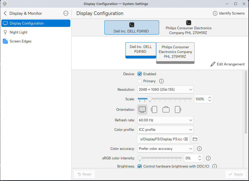

Some CachyOS users and I have encountered issues after updating to the NVIDIA 580.105.08 driver, which seem similar to the problems you described. The core problem appears to be that the graphics card fails to correctly detect the resolution and refresh rate of monitors connected via HDMI.
The issues reported in the forum threads are as follows:
1. Inability to set the correct resolution, [After updating linux-cachyos-nvidia/linux-cachyos-rc-nvidia/linux-cachyos-lts-nvidia(NVIDIA driver version 580.105.08), the dual-screen display resolution is incorrect - #10 by kentooo - Issues & Assistance - CachyOS Forum](https://discuss.cachyos.org/t/after-updating-linux-cachyos-nvidia-linux-cachyos-rc-nvidia-linux-cachyos-lts-nvidia-nvidia-driver-version-580-105-08-the-dual-screen-display-resolution-is-incorrect/18057/10) and [SUddenly missing higher resolution on second monitor - Issues & Assistance - CachyOS Forum](https://discuss.cachyos.org/t/suddenly-missing-higher-resolution-on-second-monitor/18101)
2. Inability to set the correct refresh rate, [After a nvidia graphic driver change I'm stuck at 60 Hz or lower (both in moniter info and on the pc), I should be able to get 144 Hz - Issues & Assistance - CachyOS Forum](https://discuss.cachyos.org/t/after-a-nvidia-graphic-driver-change-im-stuck-at-60-hz-or-lower-both-in-moniter-info-and-on-the-pc-i-should-be-able-to-get-144-hz/18192)
The hardware currently reported with these issues on CachyOS includes the GTX 10xx Series and RTX 20/30/40 Series. In the display settings, the correct resolutions and refresh rates are unavailable, and they cannot be forced using `xrandr` either. It has been confirmed that this is not a Desktop Environment issue, as the incorrect resolution is noticeable as early as the system boot splash screen. Furthermore, after rolling back to the 580.95 driver version, these issues no longer occur.

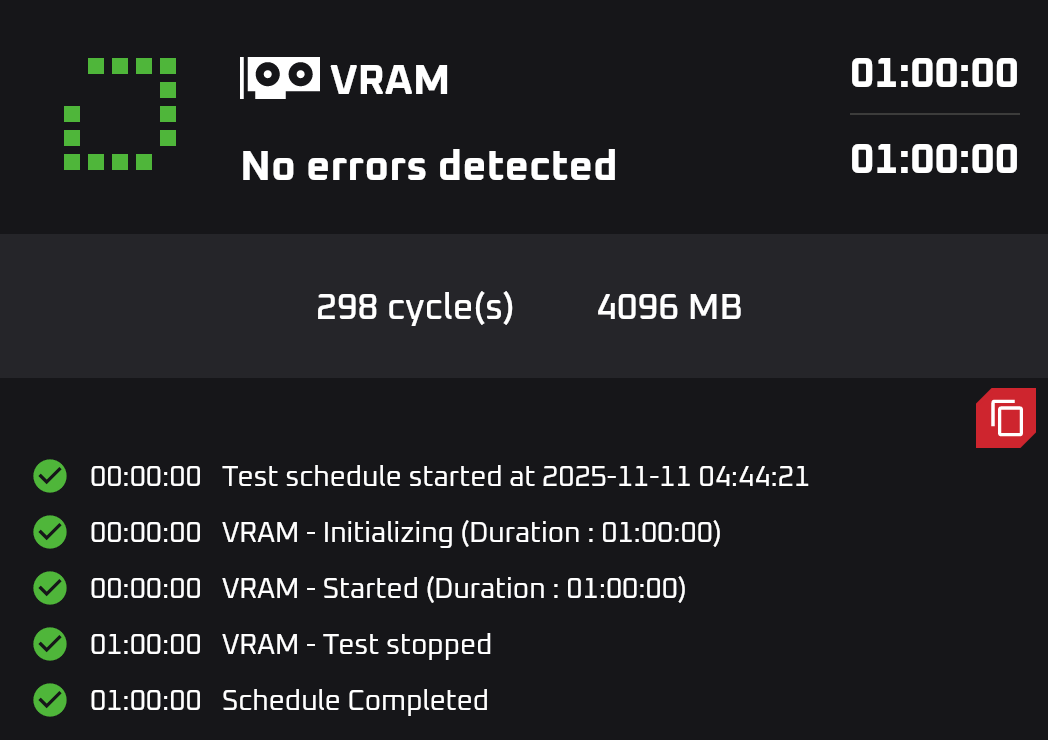

Hello there has been an issue with multiple monitors for a few driver releases now. At least when using GNOME. One of the screens randomly freezes up and one has to restart to fix it. Very annoying.
This is with version 580.95.05 and a RTX 4090.

I keep seeing these static noise glitches on my screen. I can’t be the only one seeing these?

Doesnt happen to me with a 4090 + PG32UCDP connected via DP. Maybe try another cable or underclock the vram?

Did a VRAM test:
 ![occt_memory](https://global.discourse-cdn.com/nvidia/original/4X/7/8/e/78e474afc807468d50de2c656a0b3e0b5facd038.png)
I’ve done about 8 hours at this point of OCCT stability tests. Everything passes. Maybe it’s an HDMI cable issue?
Funny thing I noticed: if VRAM is near full, GTK applications can sometimes fail to start with a “failed to get graphics context” error.

> [@BlueGoliath](#):
> Funny thing I noticed: if VRAM is near full, GTK applications can sometimes crash with a “failed to get graphics context” error.
GTK4 got a pretty severe Vulkan bug that may cause apps to crash. Probably not the cause of your crash but might be good to know. The GTK devs are aware of it.
