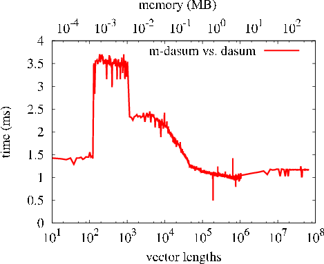

As a by-product of my project, I incidentally coded a faster DASUM program (m-dasum) than cublasDasum in CUBLAS 3.2 on Tesla C2070.
Performance:
  1. for vectors of 100 ~ 1000 elements, the speedup w.r.t cublasDasum is about 3.5.
  2. for vectors of greater than 10^6 elements, the speedup w.r.t cublasDasum is about 1.17.
  3. for vectors of the other sizes, m-dasum and cublasDasum are quite similar in performance.
