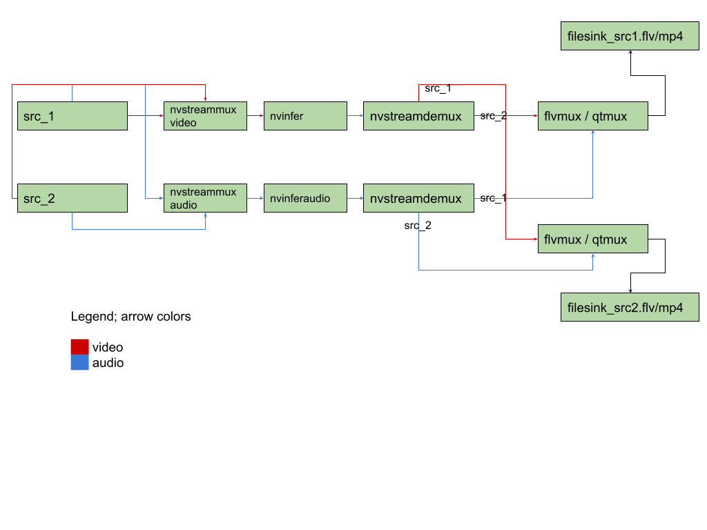

About deepstream app inferencing both nvinfer for video and nvinfer audio for audio in paralel
I found deepstream_parallel_inference_app that only support multiple models inference with nvinfer(TensorRT) or nvinferserver(Triton) in parallel.
So, I want to apply design/source code for nvinfer and nvinferaudio, Is it possible? Do you have any advice for me?

Could you describe your use case in detail?
I want to build a pipeline including both nvinfer (for handling video) and nvinferaudio (for handling audio) in parallel, the structure of pipeline is the same as below. But I dont find any source code of the below pipeline to refer. If you have, please let me know.
(Refer Gst-nvstreammux New — DeepStream 6.3 Release documentation (nvidia.com))
Can you describe your specific usage scenario, not only the pipeline? What scenario is your pipeline used to process?
