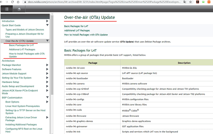

About OTA update for jetson NANO
Can anyone explain in detail about ota update?
In the name of over the air, you can see what it means to be pushed and managed completely remotely, without field work.
Can the entire ubuntu system be updated through this ota update method?
Thank you.
Hi neuezeal,
Currently we support debian packages based OTA with which one can upgrade L4T version and JetPack version using debian package management tool.
Here is some OTA info as your reference:
https://www.codepool.biz/linux-debian-reporisory-reprepro.html
