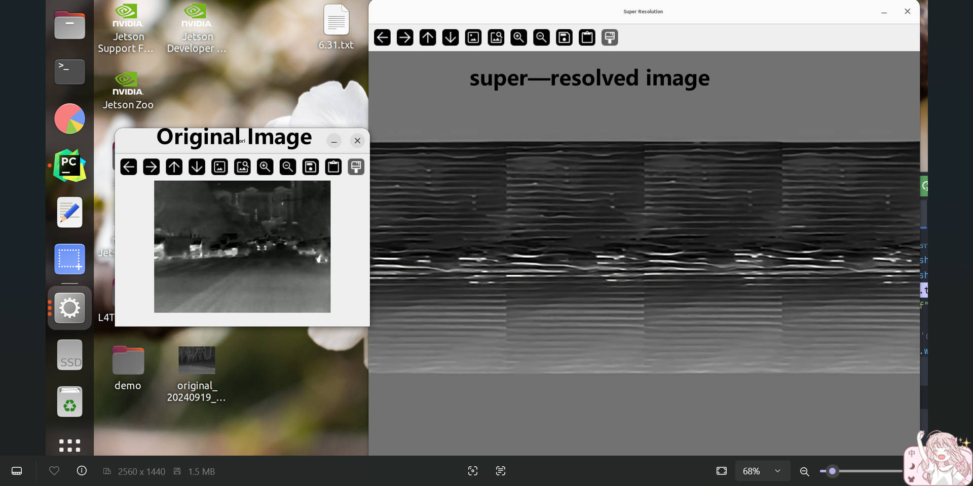

Problem description:
Hello, I can run my detection engine model or super-resolution engine model in Jetson Orin Nano separately and it works fine. But when I run the program with two models together, there will be problems, and the picture will become torn and rippled. I hope I can find and solve the problem here.I have uploaded the effect picture and related test code.

Thank you for your reply, but these commands did not work. Just like before, I ran these commands first, then ran my test program, but it didn’t work. Then I restarted and ran these commands again, but it still didn’t work. You can try running the test demo I attached in your jetson orin nano (it should be able to run directly). Is it possible that the internal scheduling will be confused or the data will be interfered when running the two engine model inferences using multithreading? Looking forward to your reply

The camera is read using USB. OpenCV is used to obtain data from a camera. Two models are used for different processing (one model detects the collected images, and the other performs super resolution). The compressed package I provided contains the video saved by our camera.
What’s the camera output size? Have try lower resolution?
The camera output size is 256*192
We think this problem is a problem with the engine’s internal reasoning, but we can’t locate and solve this problem. After all, there is no problem when running alone. So I want to ask for help here

Thanks for your reply. I understand that v4l2src is used for video acquisition tasks in Linux. However, there is no problem in outputting the acquired images through opencv.imshow() in my test code. The problem only occurs when the images are super-resolved by the model (but there is no problem running the super-resolved program alone. The problem only occurs when two engine models are used for inference in multiple processes). The following is the result of the runtime, which proves that there is no problem with the images collected from the camera. The problem only occurs after the super-resolved model. Are you willing to execute the test code I provided to see if it can be reproduced? Looking forward to your answer
Hello experts, my latest experimental problem is located in multi-threading. I tested serial operation, locked parallel operation, and unlocked parallel operation, and found that only unlocked parallel operation would have problems. It may be that multiple processes will compete for some invisible resources. Is there any way to solve this problem between multi-process reasoning? After all, the frame rate of parallel operation is 8 more than that of serial operation, which is very important to us.
At the same time, in the gpu displayed by jtop, we observed that the overall gpu utilization is not high. Is there any way to improve the gpu utilization?
