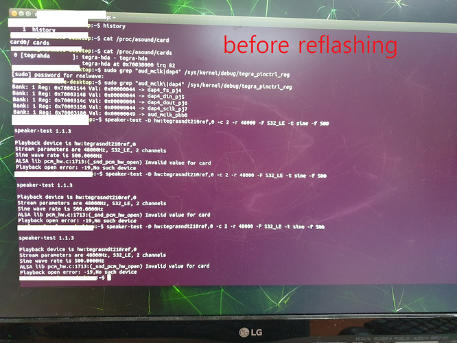

When the speaker test command is executed, it cannot be executed at first, and then it is executed on the second attempt.
But there is no sound.
  1. We use the pcm3010 codec.
  2. Use the jetson nano production module (emmc).
  3. Is it necessary to enter the target module into recovery mode before executing the next command?
  4. The next command has a very short flashing time.
    When finished, it says “The [DTB] has been updated successfully.” If you check this command, is flashing complete?
  5. When I opened the zip file, there were two .dtb and a .patch file.
    Can you describe the files?
  6. Was there anything wrong with the process of making .dtsi file through excel file and copying dtb repeatedly?
speaker-test -D hw:tegrasndt210ref,0 -c 2 -r 48000 -F S32_LE -t sine -f 500

This is result in executing command “cat /proc/asound/cards”
0 [tegrahda ]: tegra-hda - tegra-hda
tegra-hda at 0x70038000 irq 82
1 [tegrasndt210ref]: tegra-snd-t210r - tegra-snd-t210ref-mobile-rt565x
sudo grep “aud_mclk|dap4” /sys/kernel/debug/tegra_pinctrl_reg
[sudo] password for:
Bank: 1 Reg: 0x70003144 Val: 0x00000044 → dap4_fs_pj4
Bank: 1 Reg: 0x70003148 Val: 0x00000044 → dap4_din_pj5
Bank: 1 Reg: 0x7000314c Val: 0x00000004 → dap4_dout_pj6
Bank: 1 Reg: 0x70003150 Val: 0x00000044 → dap4_sclk_pj7
Bank: 1 Reg: 0x70003180 Val: 0x00000049 → aud_mclk_pbb0
Thank you.
before reflashing :
after :
But,
There is no sound when I connect the earphones.
Thank you.
