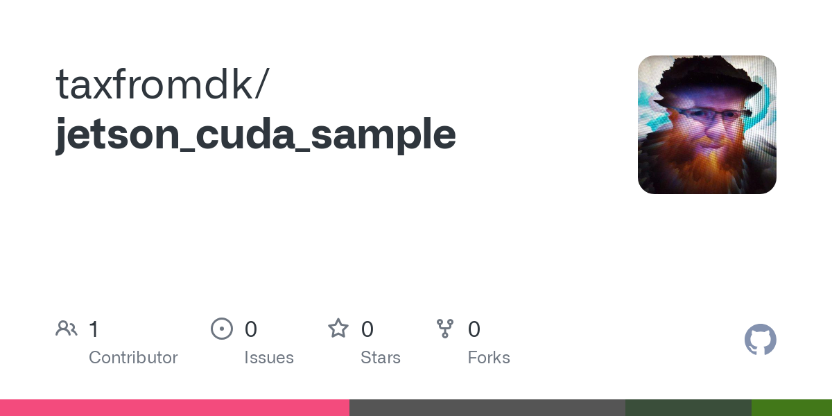

I have been spending the past days trying to access nvarguscamerasrc frames from gstreamer, but untill now with no luck. I am aware of the NV12 format (video/x-raw(memory:NVMM)) and I just need to access its y_channel.
I need to both read from and write to the y_channel.
I have shared a repo with my minimal gstreamer plugin alongside a build script that can be run by “make clean test”

The plugin I have implemented is “cudasample”
Regardless of my attempts I always get an “an illegal memory access was encountered”.
I would appreciate some pointers, or ideally a pull request, on how to access the y data from a cuda kernel.
NVMM buffer is based on NvBufSurface APIs, so you can access the buffer through the APIs. There is demonstration in jetson_multimedia_api and please check 12 sample. And nvarguscamerasrc is open source. You can customize it to add the function.
