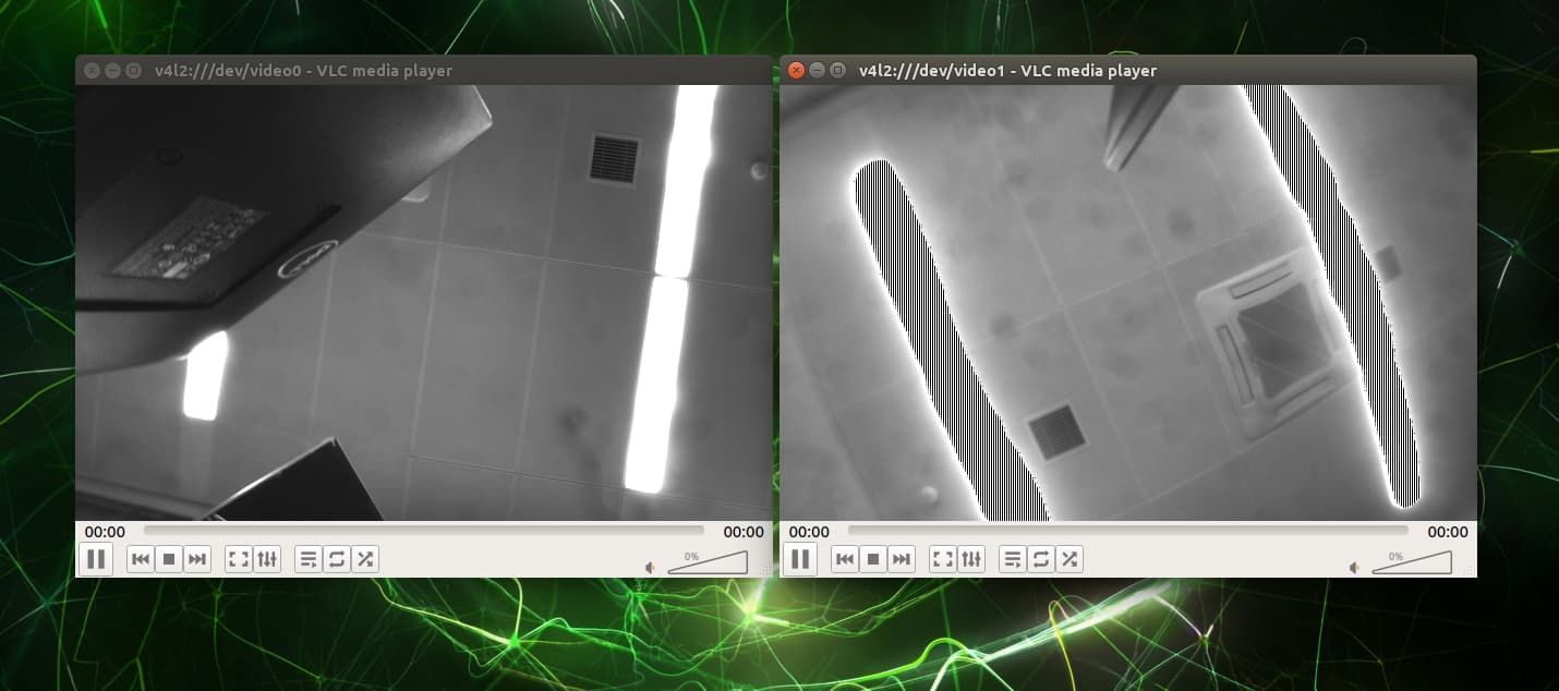

Adding second camera to TX2 p3310
Hi @ShaneCCC
update
now, the trace log shows PXL_SOF PXL_EOF etc.
     kworker/5:0-42    [005] ....   201.878667: rtos_queue_send_from_isr_failed: tstamp:6454814155 queue:0x0b4b2058
     kworker/5:0-42    [005] ....   201.878667: rtos_queue_send_failed: tstamp:6454815099 queue:0x0b4a7698
 vi-output, ov92-9110  [003] ....   201.878746: tegra_channel_set_stream: 150c0000.nvcsi--1 : 0x1
 vi-output, ov92-9110  [003] ....   201.878749: csi_s_stream: enable : 0x1
 vi-output, ov92-9110  [003] ....   201.878801: tegra_channel_set_stream: ov9281 2-0010 : 0x1

The trace log show the CHANSEL_SHORT_FRAME that tell the output size didn’t as expected.
Hi @ShaneCCC
We dump the two sensors, but their indexs are the same. We thought that there should be index0 and index1, refer to this post.

is the mapping right?
What’s more, how to debug CHANSEL_SHORT_FRAME promble, we have been trapped in it.

Hi @ShaneCCC
in the past week, we took national day holidays. sorry for our delay.
we think it’s one step to success. the following is screen shot. video0 and video1 can work independently. But, video1 cannot work smoothly.
inorder to resolve the “PIXEL_SHORT_LINE” problems, we only change the camera_common_frmfmt struct in the ov9281_mode_tbls.h file.
from
{ { 640, 400 }, ov9281_60fps, ARRAY_SIZE(ov9281_60fps), 0,
	  OV9281_MODE_640X400 },
to
{ { 620, 400 }, ov9281_60fps, ARRAY_SIZE(ov9281_60fps), 0,
we do not change camera_common.c, could you help us. we should modify which function to narrow down height?
Suppose your modification is correct.
Have a confirm by “v4l2-ctl --list-formats-ext” for your modification.

N.B. the following trace log is recorded in the condition of only video1 working.
We change the video1 DT active_h from 400 to 480, because as you mentioned
we try to expend the DT active_h. It realy helps a lot, v4l2 capture frame rate change from 1 to 60 fps, but still not stable.
henry_trace_tag1013.log (55.4 MB)
Does the sensor have exposure/frame rate control function? Try to modify those control function as dummy function to verify.
there are sill some problems, but our projects need to do other serious issues firts.
so, we tag a MARK here, and going to figure it out later.
