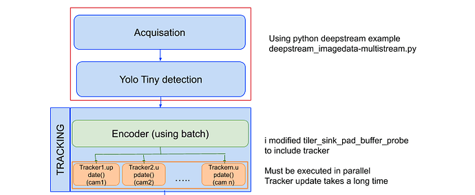

hi ,
I added a deep learning tracker (using encoder and python) to multicamera detection, deep streams, I used encoder in batch to get the features of no detections, then I used a tracker update function to update the tracker. I used an instance of tracker class because I used multicamera.
the problem is the tracker update is a little slow 0.007s and up to 0.02 s so I need to run the tracker updates () function in parallel using CPU.
The problem is when I run this function in parallel using thread or multiprocessing, the code run very slow 0.6 fps, or without parallel function is running with 15 fps.
is the deepstream pipeline can’t run with CPU thread or multiprocessing?
is there’s a way to run this function in parallel (run trackers instances update to all cameras in parallel)?

hi , thank you @DaneLLL , i use deepstream sdk 5.0 , i modified deepstream_imagedata-multistream.py to use yolo tiny v3 and i addede tracker in function tiler_sink_pad_buffer_probe (to use opencv image)

So your environment is Xavier/r32.4.2, DS SDK5.0.
The reference sample is:
Please share a patch on the sample so that we can understand your usecase.
You may try sudo nvpmodel -m 0 and sudo jetson_clocks to run Xavier in maximum performance.
