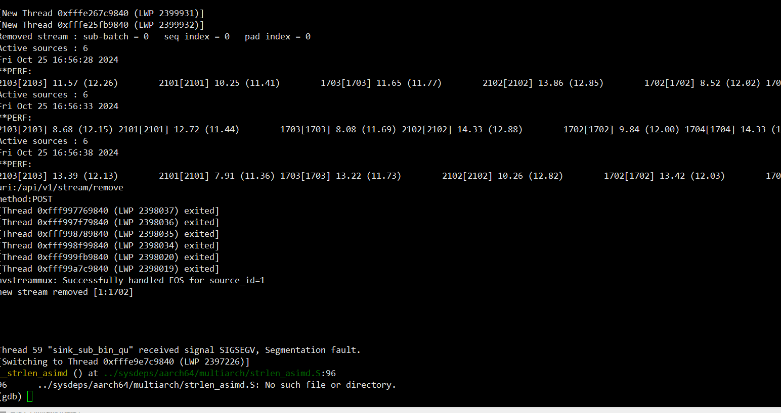

After deleting the video stream, DeepStream-Test5 program restarts
This test is based on the deepstream-test5-app module testing,

    Possible phenomenon of Deepstream-Test5 app reboot
    This phenomenon is not a necessary occurrence, but it may occur several times with multiple tests
log20241024.zip (9.0 KB)
Are you run the deepstream-test5-app in docker container? Not sure the log means deepstream-test5-app restart or the docker container restart? Can you run deepstream-test5-app with: gdb --args deepstream-test5-app? So it will stop when crash instead of restart.
Yes I run the deepstream-test5-app in docker container
Is it possible to run deepstream-test5-app with gdb and reproduce the issue?
I try it
Thanks you I try it with gdb .This phenomenon is not a necessary occurrence, but it may occur several times with multiple tests.
OK, please try to reproduce and share the gdb logs. Thanks!
Can you input: (gdb) bt to get backtrace of the crash?
I remember you have some changes for msgconvert. Can you add some log to debug the isssue? Seems need add some protect code to avoid crash. Something like NULL string point crash.
