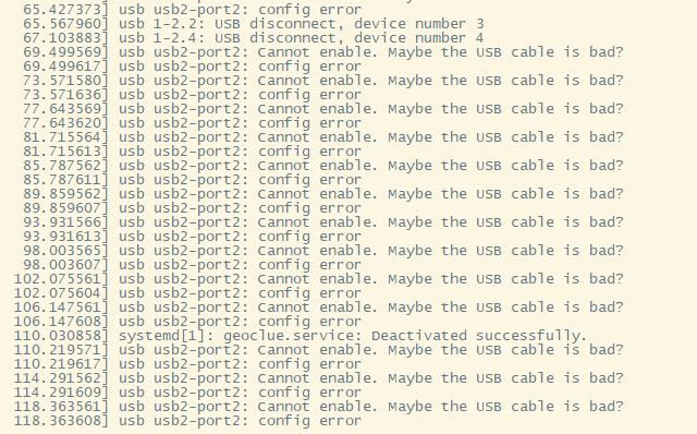

Thank u for ur suggestion.I restore the platform, i.e., re-flash the whole device with locally built SPE firmware without an change,and it boots well,but get something error like this
boot.txt (46.2 KB)
I’m sure it can start up normally. I’ve decided to ignore this issue for now. Now I will update the pinmux setting or the firewall setting, as described in “rt-aux-cpu-demo-fsp/doc/spi-app.md,” and keep the built SPE firmware with the original source.
