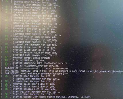

After transplanting xenomai, the graphical desktop cannot be started normally, and the serial port can enter the system normally
I migrated the system according to the attached tutorial below, the file is from Deniz Ugur
KERNEL.pdf (177.9 KB)
Deniz Ugur is based on the JETSON AGX platform and kernel-5.10.0 version and jetpack4.3 for operation. Because I can’t use the sdk manager to flash jetpack4.3 now, I tried jetpack 4.4 and jetpack4.5.1, the phenomenon is the same, serial port Able to enter the system but the desktop will hang, the relevant log is as follows
dmesg_log.txt (36.1 KB)
serial_log.txt (209.1 KB)
Please help analyze the Log and determine the source of the problem
