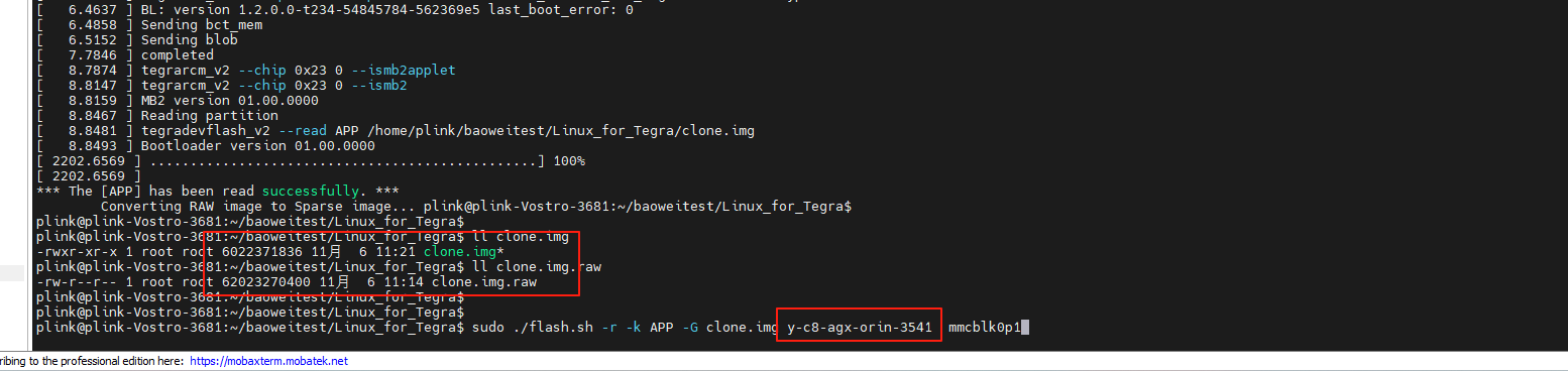

I just tried it out. The command I used was:
sudo ./flash.sh -r -S 3471320KiB y-c8-agx-orin-3541 mmcblk0p1
Still getting an error. May I ask if you could test it with the official suite on your end?
What’s the exact size of your system.img.raw?
What’s the exact size of your APP partition before flash?

For reference, 62024007168 is not the same as what I saw earlier. This cannot be divided evenly by 1024 even a single time, so something has changed. I’m not sure what the cause of that would be, or how well that change can be accommodated by the flash software.
“y-c8-agx-orin-3541” is our self-developed baseboard. Compared with the official baseboard, it only has expanded the interfaces.
Because two days ago, I kept testing with our official baseplate, but before your reply, I had been constantly trying. 62024007168 is the result of my device flashing with the devkit, backup, and then restoration yesterday.
I’ll look for another machine today. Let’s synchronize the base plate and the devkit. I’ll send you the Image size shortly.

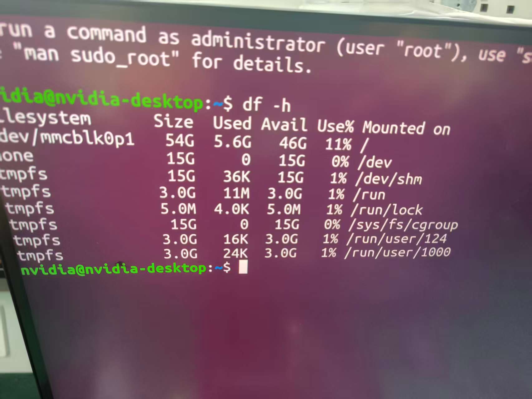

When I use devkit
The backup command and results are as follows:
When I Use custom board:
Please take a look at it. If possible, you can also test this version.

It is interesting that it isn’t divisible by 4096 or 1024. On the system which is the “donar” of the partition being cloned I’m guessing it was supposed to be a block size of 4096. On that donar system (the source of the clone image) what do you see from:
cd
stat -f .
I am also curious if changing your carrier board results in a “normal flash” (not a clone restore and not a partial flash) have any difference in the partition size (the bootloader/system.img.raw) or block size.
