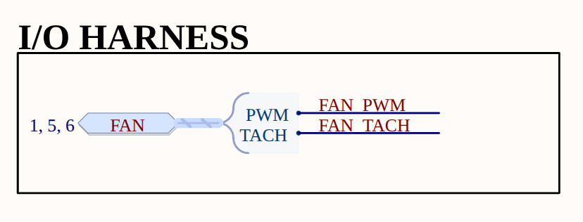

My fan tachometer reading is always 0, despite the fan moving. This results in nvfancontrol slowly ramping the fan speed up to 100% and staying there.
(The current workaround I’m using is to kill nvfancontrol and manually set PWM to around half speed).
Probing with an oscilloscope, I see the tachometer reading is very weak / noisy. You can see there is a reading, but it appears as if it is being pulled to ground. Using the same fan on a different compute module I have (on the same carrier board, with the same tachometer input circuitry), I get a strong, clean square wave.
My suspicion is that there may be a pull down resistor configured somewhere in the device tree / pinmux which is dragging the tachometer signal down to an unreadable voltage level. I haven’t managed to find this yet.
Any suggestions / help would be greatly appreciated.
I’ve attached images of the schematic for the fan connections on the custom carrier board. Fan is 12V, but voltage levels are shifted as necessary. Just to reiterate, the same fan works fine on identical Tach Input circuitry, going into a different compute module on the same board.

  1. Review the device tree configuration: Check the device tree configuration for the Jetson AGX Orin module to see if there are any pull-down resistors configured for the tachometer signal. Specifically, look for any entries related to the tachometer signal in the device tree file.
  2. Check the pinmux configuration: Verify the pinmux configuration for the tachometer signal to ensure that it is not being pulled down to ground. Check the pinmux settings for the tachometer signal and compare them to the settings for the same signal on the different compute module that works fine.
  3. Measure the voltage level: Use an oscilloscope to measure the voltage level of the tachometer signal at the input of the Jetson AGX Orin module. Compare this to the voltage level of the same signal on the different compute module that works fine.
  4. Compare the schematic: Compare the schematic of the fan connections on the custom carrier board to the schematic of the fan connections on the different compute module that works fine. Look for any differences in the circuitry that could be causing the issue.
In terms of the provided images, I would suggest reviewing the schematic for the fan connections on the custom carrier board (tachinputjetson) and comparing it to the schematic for the fan connections on the different compute module that works fine.
