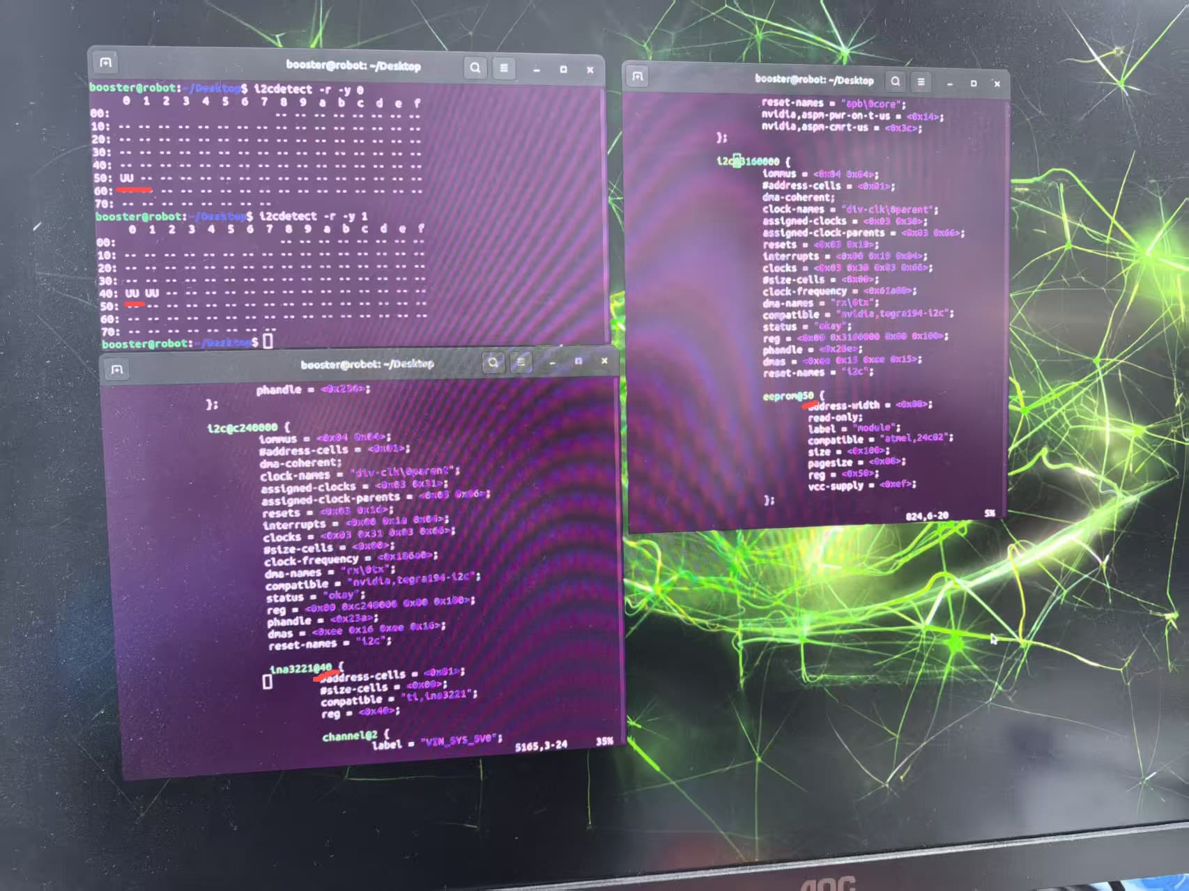

The cann’t to boot is occasional, occurring only once every few dozen times. After boot ok, the I2C address configuration can be seen as 0x40 through the reverse device tree.
May I ask what else can be investigated? May I ask which I2C channel corresponds to the hardware of this I2C bus? I2C1 (pin-K5/L8) or I2C2 (pin-J61/K61)
Should be the i2c@3160000
From the serial port information, it is not indicated that there was an error reading eeprom, but rather an error accessing the device with address 0x40 by i2c. The device with address 0x40 can be seen as a power monitoring chip through the device tree. Will this affect the startup? Or was it supposed to read eeprom, but got it wrong?What other places can be look?
This is the relevant information after normal startup.
