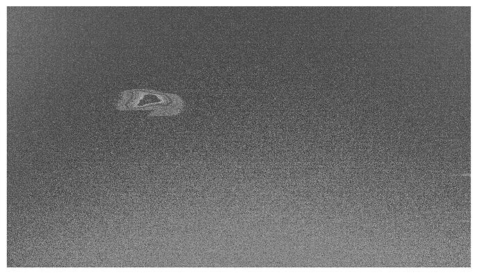

And we use gst-launch-1.0 nvv4l2camerasrc device=/dev/video0 '!' 'video/x-raw(memory:NVMM)' '!' nvvidconv '!' 'video/x-raw(memory:NVMM),width=1920,height=1080' '!' nv3dsink to preview raw but getting all black image
I don’t think nvv4l2camerasrc able support RAW sensor. You may verify by nvarguscamerasrc.
The frame rate problem could cause by incorrect xxx_set_framerate()
Got No cameras available error
nvidia@nvidia-desktop:~$ gst-launch-1.0 nvarguscamerasrc sensor-id=0 ! 'video/x-raw(memory:NVMM),width=1920,height=1080,framerate=30/1' ! nvvidconv ! 'video/x-raw,format=I420' ! xvimagesink
Pipeline is live and does not need PREROLL ...
New clock: GstSystemClock
Error generated. /dvs/git/dirty/git-master_linux/multimedia/nvgstreamer/gst-nvarguscamera/gstnvarguscamerasrc.cpp, execute:751 No cameras available
WARNING: from element /GstPipeline:pipeline0/GstXvImageSink:xvimagesink0: Pipeline construction is invalid, please add queues.
Additional debug info:
gstbasesink.c(1209): gst_base_sink_query_latency (): /GstPipeline:pipeline0/GstXvImageSink:xvimagesink0:
Not enough buffering available for  the processing deadline of 0:00:00.015000000, add enough queues to buffer  0:00:00.015000000 additional data. Shortening processing latency to 0:00:00.000000000.
Got EOS from element "pipeline0".
Execution ended after 0:00:00.002298270
Setting pipeline to NULL ...
Freeing pipeline ...
That could be incorrect information in tegra-camera-platform{} in camera device tree.
Fixed that, but still the same black
Looks like nvarguscamera unable capture from the sensor.
You may need confirm the tegra_sinterface for your sensor connection.
Doesn’t it mean CSI-A connected?
BTW, We use nvv4l2camerasrc to view raw on another ov5647 module and success.
You may modify the CID function like xxx_set_exposure()/xxx_set_framerate to dummy function to clarify.
We did make these dummy function, since we port the driver from imx185 as the guide did.

I capture raw using v4l2-ctl -d /dev/video0 --set-fmt-video=width=3840,height=2160,pixelformat=RG12 --stream-mmap=3 --stream-skip=10 --stream-to=08b-dot.raw --stream-count=1 --stream-poll and view it on my pc tool, it seems ok with the raw.
You may need to confirm the sensor REG dump to compare to narrow down the problem.
Hi @ShaneCCC
We were trying some modification on the mode, and found that when pixel_phase changing from rggb to bggr, we got kernel panic:
