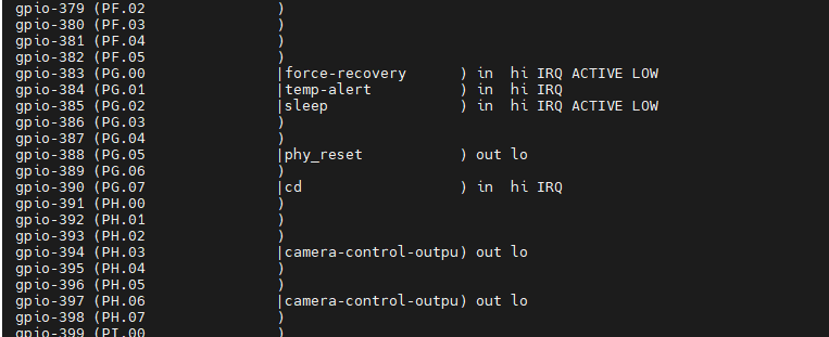

We have a custom carrier board with the Marvel 88E1512 Phy connected AGX Orin module.
1. We modify the ODMDATA field to disable the 10G ethernet and allow the Orin to boot.
> ODMDATA=“gbe-uphy-config-0,hsstp-lane-map-3,nvhs-uphy-config-0,hsio-uphy-config-16”;
1. We modify the pinmux as suggested in the developers guide.
> [Orin-jetson\_agx\_orin-gpio-default.dtsi](https://forums.developer.nvidia.com/uploads/short-url/pnnzdgFoRPfUPIhTOmfgUztmZlF.dtsi) (3.9 KB)
> [Orin-jetson\_agx\_orin-pinmux.dtsi](https://forums.developer.nvidia.com/uploads/short-url/2Cl0QZEkDsVk7tWlSgAZigaf4gi.dtsi) (64.6 KB)
1. We modify the device tree as suggested in the developers guide.
> [tegra234-ethernet-3737-0000.dtsi](https://forums.developer.nvidia.com/uploads/short-url/vHPT8qeFv8yxjuBR3gkHBDINDWb.dtsi) (1.6 KB)
> [tegra234-p3701-0004-p3737-0000.dts](https://forums.developer.nvidia.com/uploads/short-url/qk1It0mozszRUEWChrcplG6KtE5.dts) (490.3 KB)
There is always an error when running on the board：
> [37.460487] nvethernet 2310000.ethernet: failed to connect PHY
> [37.466642] net eth0: ether\_open: Cannot attach to PHY (error: -19)
> This is boot log [boot.txt](https://forums.developer.nvidia.com/uploads/short-url/kbyesvRdIwxI4w2zs94QlQnVXBh.txt) (56.9 KB)
**sudo ifconfig eth0 up**
> [35217.650577] nvethernet 2310000.ethernet: failed to connect PHY
> [35217.656627] net eth0: ether\_open: Cannot attach to PHY (error: -19)
> SIOCSIFFLAGS: No such device
**sudo cat /sys/kernel/debug/gpio**
 ![image](https://global.discourse-cdn.com/nvidia/original/3X/d/9/d9dc1c24f0289c384ca2c6d1fb07a8c0313ab017.png)
Can anyone help me see what I did wrong will cause this issues?

Are you sure the pinmux file gets flashed to your jetson is really Orin-jetson\_agx\_orin-gpio-default.dtsi and Orin-jetson\_agx\_orin-pinmux.dtsi ?
Also, there is something wrong with online document. Please refer to this doc instead.
> **[Adaptation\_and\_Bringup\_for\_Jetson\_AGX\_Orin.pdf](https://developer.download.nvidia.com/assets/embedded/secure/jetson/agx_orin/Adaptation_and_Bringup_for_Jetson_AGX_Orin.pdf?OmqSodHzsL1KTQiuWkgQuU597wdLWkLGIj3z1jb_zhxI4AYEaM955IJuC0ebydHgWR8fUODxef8ZwJb_OKSSIpytmYUNy---glG5aAvOicDS1zkXbuUEXR0MdZDfiIu8LQ4mfF-TWK9hK0BbIB8LPXwCYzwBc4n1cC_pw1L68dnICVKTerGIUCYNNiBmSrIbhySiug==)**
