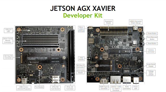

AGX xavier dev kit faulty USB-C cannot flash
I will try the 3p server thing as soon as I can.
The dmesg does detect something on the j512 port
when the device is put into recovery mode.
How can I talk to the 3p server to flash the device and bypass the faulty j512 port? Is this even possible?
Is the J512 you are speaking of the USB connector on the right side of the 40-pin header? If your host PC does not see anything when the Jetson is in recovery mode, upon cable insert, then there is a hardware issue. The exception would be a VM or container being misconfigured. If this is straight to another Linux computer and plugging that in does not show up on “dmesg --follow”, then we can call that hardware failure.
The 3p server is a bit of an undocumented black box which NVIDIA has not released. It is what runs when the Jetson is in recovery mode. You don’t talk to it per se, but the flash software does. That talking is via the USB connector on the right of the 40-pin header. Any time the Jetson is in recovery mode the 3p server is available.
Yes it’s the one marked ‘flash/debug’, and it is the one that seems to be the issue. The image I sent previously confirms that the host PC does register activity when the device is connected in recovery mode.

The thread is getting long so forgive me if I restate some things, but double check what I’m summarizing. Here is what we actually know (sorry for this long summary, hoping it helps to show history and logs in one place; maybe @DavidDDD or someone else who knows more about the “tegrarcm_v2 --isapplet” mentioned near the end can answer if this is really a hardware failure; numbering bullet points):
  1. USB itself is verified. There is dmesg activity upon insert of USB cable from Jetson to host PC when the Jetson is in recovery mode.
  2. Host PC side flash software is not detecting the Jetson, suggesting (in conflict with the first statement) that USB does not work. In a log:

  1. Yes there is dmesg activity on host PC when the Jetson is connected in recovery mode. I guess this means that the flashing USB C connection (J512) works at least initially.
  2. The host PC flash software (either flash.sh or SDK manager) is detecting the Jetson in recovery mode initially, but once the Jetson is disconnected for the first time by the flashing software it apparently does not ever reconnect again by itself. It is from this point on that the ‘USB communication failed’ messages appear in the logs.
  3. Yes, the previous owner’s (password-protected) build is still on the eMMC.
  4. I guess I agree.
  5. Serial USB output with gtkterm on host PC does indeed show ‘entering 3p server’ when the Jetson is connected in recovery mode and when flashing is initated (either by flash.sh or the SDK manager) but it goes no further.
  6. Yes, I think you are right. Once the initial USB connection is lost and not automatically regained, the 3p server receives no further commands and flashing fails (it makes me wonder what the host PC thinks it is flashing up to 99%). I have tried a number of cables now, including bona-fide USB 2.0 cables, and routing through USB hubs, and while it has had an effect on the percentage attained before failure it has evidently not solved the issue. The cables and host PC setup have successfully flashed other AGX Jetson Dev Kits without problem.
I understand that despite our (mainly yours!) best efforts we have identified a likely hardware root cause, but unfortunately nothing approaching a resolution as of yet. Oh dear :/.
