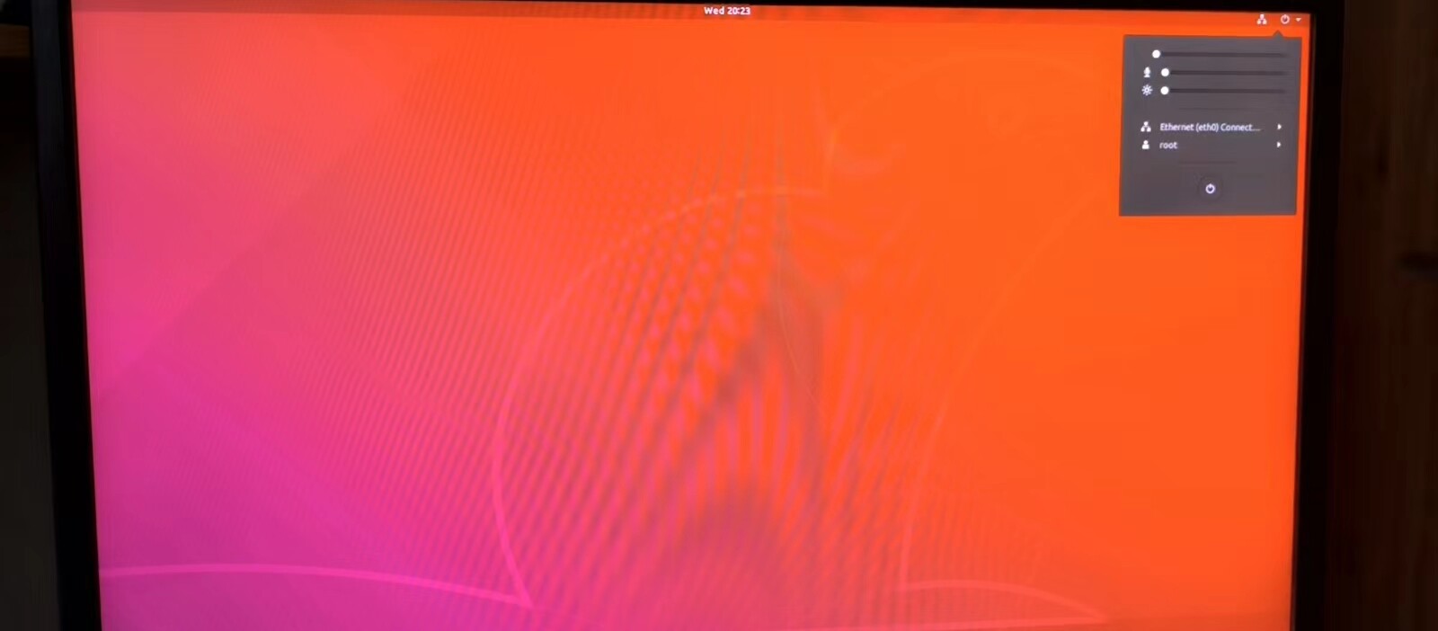

I build L4T with default config and without any code change.But after I flash image to devkit by
$ sudo ./flash.sh jetson-agx-xavier-devkit mmcblk0p1
,it seem that devkit freeze in the serial because not response when hit key and can’t enter Command line prompt.
Another,the mouse and event is active on the HDMI screen of devkit.
Attachment is the serial log of devkit and picture of HDMI output.Any suggestion is helpful, thanks!

Hi sdz_2011,
Are you using the devkit or custom board for AGX Xavier?
[   11.448134] Please complete system configuration setup on desktop to proceed...
It seems your board is in the process of oem-config.
Have you tried to reset the board and it still stuck here?
Or you could just refer to the following instruction to pre-config these before you flash the board.
Flashing and Booting the Target Device - Skipping oem-config
Hi KevinFFF:
I use the devkit for AGX Xavier
I have tried to reset or repower the board and it still stuck in:
Kevin’s point is you need to follow the guidance he shared in that link…
If you just reset or repower, then it won’t work.
