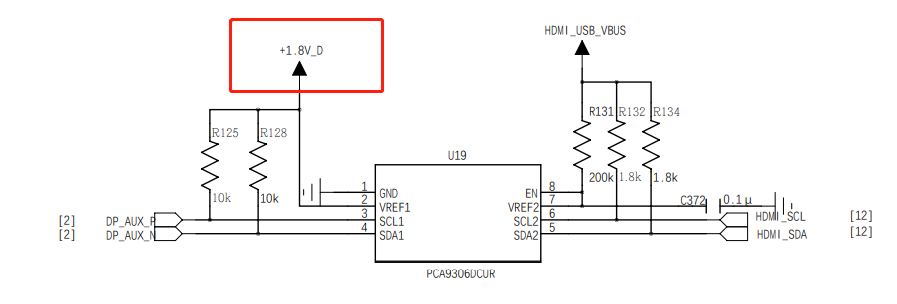

Our new carrier board use the HDMIDP0-TXDP0 , not use the HDMIDP2-TXDP2
so I change the device -tree file
hardware/nvidia/platform/t19x/galen/kernel-dts/common/tegra194-p2822-disp.dtsi
like this:

and then the log like this
[ 0.000000] earlycon: tegra_comb_uart0 at MMIO32 0x000000000c168000 (options ‘’)
[ 0.000000] bootconsole [tegra_comb_uart0] enabled
[ 1.849542] ucsi_ccg 1-0008: read version failed
[ 1.849661] ucsi_ccg 1-0008: get_fw_info fail, err=-121
[ 2.426820] rt5659 7-001a: Device with ID register ffffff80 is not rt5659
[ 2.525848] tegra-asoc: sound: ASoC: CODEC DAI rt5659-aif1 not registered
[ 2.526040] tegra-asoc: sound: snd_soc_register_card failed (-517)
[ 4.499951] tegra-asoc: sound: ASoC: CODEC DAI rt5659-aif1 not registered
[ 4.500123] tegra-asoc: sound: snd_soc_register_card failed (-517)
[ 4.514028] tegra-asoc: sound: ASoC: CODEC DAI rt5659-aif1 not registered
[ 4.514215] tegra-asoc: sound: snd_soc_register_card failed (-517)
[ 4.846010] cgroup: cgroup2: unknown option “nsdelegate”
[ 5.265760] tegra-asoc: sound: ASoC: CODEC DAI rt5659-aif1 not registered
[ 5.265954] tegra-asoc: sound: snd_soc_register_card failed (-517)
[ 6.098154] tegra-asoc: sound: ASoC: CODEC DAI rt5659-aif1 not registered
[ 6.098341] tegra-asoc: sound: snd_soc_register_card failed (-517)
[ 6.099263] Could not get extcon-dev /host1x/nvdisplay@15200000:typec0(0)
[ 6.103822] Could not get extcon-dev /xhci@3610000:id(0)
[ 6.107599] Could not get extcon-dev /xudc@3550000:vbus(0)
[ 6.109754] tegra-asoc: sound: ASoC: CODEC DAI rt5659-aif1 not registered
[ 6.109935] tegra-asoc: sound: snd_soc_register_card failed (-517)
[ 6.115573] Could not get extcon-dev /host1x/nvdisplay@15200000:typec0(0)
[ 6.119121] Could not get extcon-dev /xhci@3610000:id(0)
[ 6.134195] Could not get extcon-dev /xudc@3550000:vbus(0)
[ 6.136341] tegra-asoc: sound: ASoC: CODEC DAI rt5659-aif1 not registered
[ 6.136514] tegra-asoc: sound: snd_soc_register_card failed (-517)
[ 6.138968] Could not get extcon-dev /host1x/nvdisplay@15200000:typec0(0)
[ 6.142914] Could not get extcon-dev /xhci@3610000:id(0)
[ 6.310282] random: crng init done
[ 6.310387] random: 7 urandom warning(s) missed due to ratelimiting
[ 7.123622] Could not get extcon-dev /xudc@3550000:vbus(0)
[ 7.125780] tegra-asoc: sound: ASoC: CODEC DAI rt5659-aif1 not registered
[ 7.125949] tegra-asoc: sound: snd_soc_register_card failed (-517)
[ 7.127076] Could not get extcon-dev /host1x/nvdisplay@15200000:typec0(0)
[ 7.131043] Could not get extcon-dev /xhci@3610000:id(0)
[ 7.214935] CPU4: shutdown
[ 7.266435] CPU5: shutdown
[ 7.322367] CPU6: shutdown
[ 7.398255] CPU7: shutdown
[ 8.367804] Bridge firewalling registered
can you give me some suggest?
