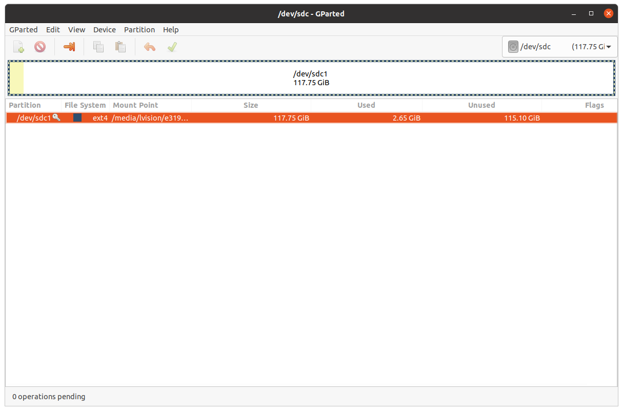

@WayneWWW This is that SD card from my host computer, it’s formatted to ext4 already, and I tried multiple times and gurantee it’s entirely in ext4.
Is a partition fat16 a must?
What’s more, I’m testing a SD card of size 128G. I think the previous pastepin is before rebooting. Now, I insert this unworking 128G card into AGX first, and then reboot AGX, the current dmesg is here https://pastebin.com/095MzvxK . Any more suggestions?
