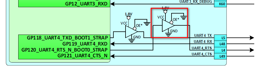

I have noticed that UART4_RTS on camera connector has weird behaviour when it is configured as Input.
When I configured it as Input, the voltage was immediately pulled to 1.8V, but it shouldn’t because it is floating and pull-up is turned off. I checked it twice. What is more, when I connect external device’s gpio to this pin, it couldn’t pull it down, even with high drive on output(voltage drops to 1.6V).
Is there anything I might have missed?

EDIT:
I found that CAM_ERRROR_4 has label VSYNC on the schematic. Is there any reason why?

Hi, it can only be output because of a buffer used on module as below showing.
Thank you.
It is as I thought, but do you know why it is VSYNC on the schematic? It doesn’t make sense since it is output and there is no timer there.
It is a inherited reserved design in which there is an unmounted bypass 0 ohm in parallel with buffer. In fact, it is used as RTS or output GPIO only. You can ignore the vsync word in schematic.
Thank you for the explanation!
