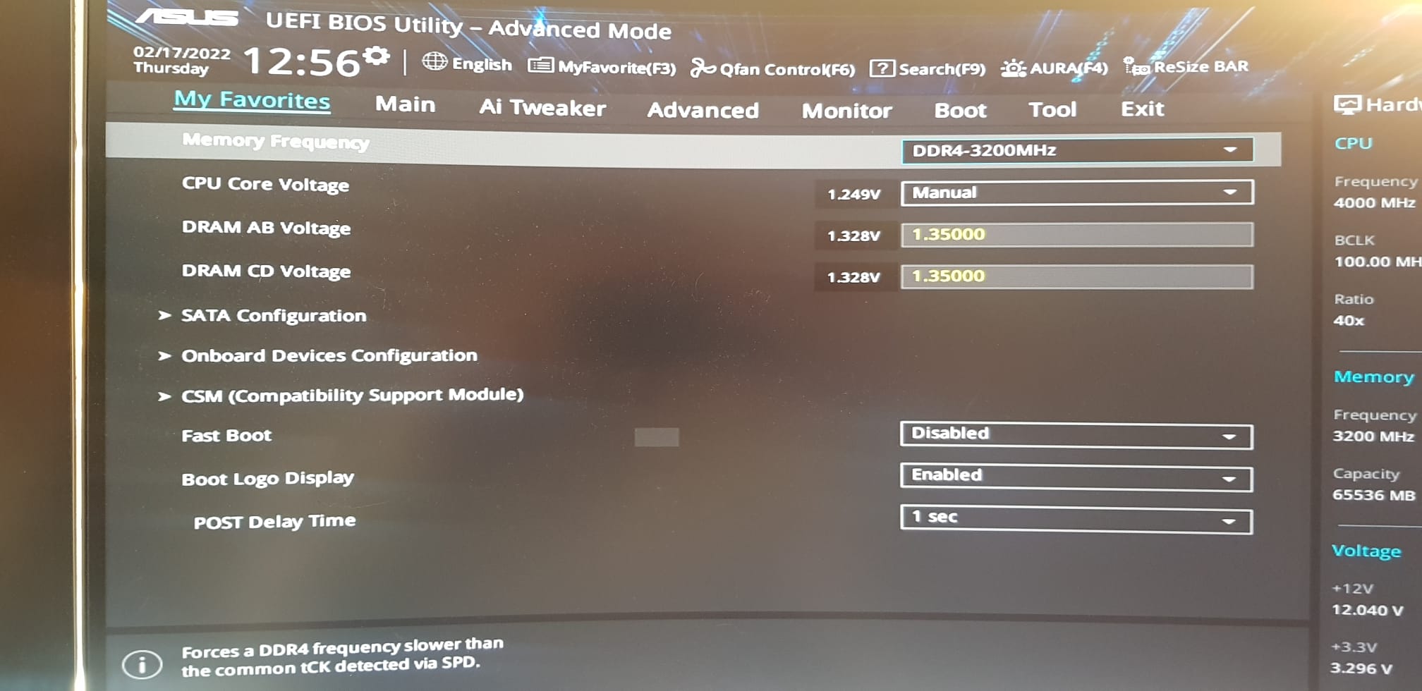

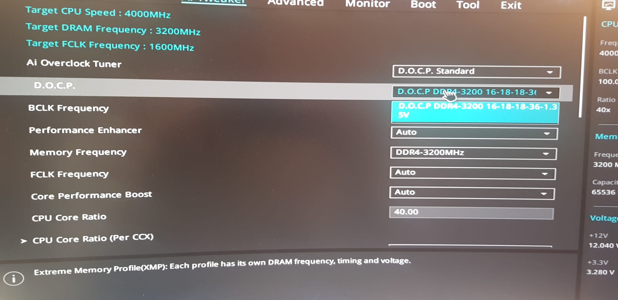

The bios came preconfigured and i bought some extra RAM afterwards.
The pc came with (2 x 16GB) of Corsair CM4X16GC3200C16K4 16GB
I bought some extra (2x 16GB) Corsair CMG32GX4M2E3200C16 (so same 3200MHz, cas)
I uploaded a picture from the settings (should be ok i think?)
Don’t know why it says: Forces a DDR4 frequency slower than the common tCK detected via SPD.
The setting is fine, 3200MHz is what the cpu and memory supports.
