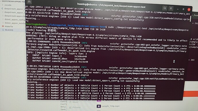

I run the deepstream-appsrc-test example on my orin nano.
The console keeps outputting debugging information, but the graphics window playback card stops playing at the first frame.
Is there any question ?
could you share the whole log? here is my test log log.txt (1.6 KB). it worked well. please refer to readme for how to run.

from the second screenshot, the app worked well. what do you mean about “connect to display the file”?
Oh, it means play the video, and the video stop playing, but logs normal.
