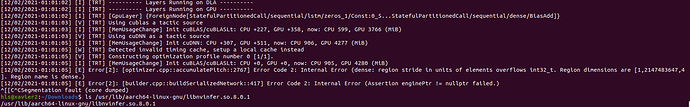

Hi @NVES @spolisetty ,
I am facing the same issue. I simplified my algorithm to maximum possible extent. No matter which approach I use for generating the TRT engine i.e., using TensorRT python API or using trtexec, I see the same error eventually after resolving all other conversion issues.
Here is the error output:
I simplified the ONNX model using ONNX-simplifier but the same error persists.
Please suggest a workaround, I did not find any solution in other discussion threads.
