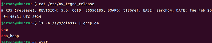

The dir /sys/class/dmi seems in r36.x. How about the version files in r35.6.0?
I’ve just gotten a AGX Xaiver devkit with Jetpack 5.1.5(L4T r35.6.1) to check.
$ cat /etc/nv_tegra_release
# R35 (release), REVISION: 6.1, GCID: 39721438, BOARD: t186ref, EABI: aarch64, DATE: Tue Mar  4 10:13:09 UTC 2025
$ cat /sys/class/dmi/id/bios_version
6.1-39721438
$ cat /sys/class/dmi/id/bios_date
03/04/2025
Version in nvme is 35.5.0.
There is no dmi dir, as show in picture. What can I do next?
Please run the following command to check if the related kernel configs have been enabled on your board.
$ zcat /proc/config.gz |grep "CONFIG_DMI"
Or you can just simply check the version strings showing in serial console log during boot up.
e.g.
Jetson UEFI firmware (version 5.0-c0c53dad built on 2024-04-13T16:01:54+00:00)
Kernel “config_dmi” on my target board is not set.
I noticed this strings on screen before. Built time doesn’t change, still on 2024-8-28…
I follow the steps. Build uefi_StandaloneMmOptee_RELEASE.bin, build tos img, but only update tos image in <Linux_for_Tegra>/bootloader/tos-optee_t234.img. This may be the reason, why uefi built time string not changed.
Now, are there any way to tell them apart?
Okay, it is expected that the UEFI version/build time are the same since you don’t update UEFI binary.
