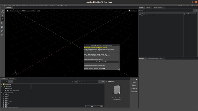

Hi
I just installed Isaac Sim for the first time. However, it seems that there are no assets. What should i do?
Hi
https://docs.omniverse.nvidia.com/prod_nucleus/prod_nucleus/installation/workstation.html
Did not do this.
i did this, but didnt work for me. When i go to Isaac Utils → Nucleus check i only get a pop-up saying Nucleus detected succesfully. I never get an option to download assets. Do you have any idea what might have gone wrong. If i disable Nucleus via localhost:8080 i get the same popup as @DDPG7 with no option of downloading assets.
Does the “localhost /Isaac” folder exist?
In that case, delete it.
Then , go to: http://localhost:3080/
Stop cache.
And, restart “IsaacSim”
Is there a download button?
Yeah that worked! It is downloading now. Thank you very much.
