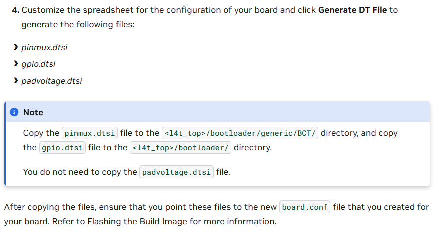

I am trying to find the steps to update pinmux configuration.
I found excel sheet “Orin\_Jetson\_Series\_Pinmux\_Config\_Template\_2.0.xlsm” that is used to generate new dtsi files, but how do I apply them to system?
There are no useful links for this…

> [@cveks](#):
 ![image](https://global.discourse-cdn.com/nvidia/original/4X/2/a/0/2a0ffdc8beccc2723a26b23b5326c10f9ded1b0a.png)

When I was flashing Orin first time, I used next command:
```auto
sudo ./flash.sh jetson-agx-orin-devkit mmcblk0p1
This means flash script will use “jetson-agx-orin-devkit.conf” configuration file.
Picture from above states that once I generate pmux and gpio files, I should copy them to specified location then point to them inside new board conf file.
How do I add these new files to new board config file?

> [@cveks](#):
> just need to.. copy both files and it will work.
copy files to the folders specified in the documentation below:

Managed to resolve.
Steps:
1. Using excel sheet generate new configuration
2. Take gpio.dtsi and pinmux.dtsi files only
3. Copy gpio.dtsi to Linux\_for\_Tegra/bootloader
4. Copy pinmux.dtsi to Linux\_for\_Tegra/bootloader/generic/BCT
5. Inside pinmux.dtsi change “./gpio.dtsi” to #include “gpio.dtsi”

> [@cveks](#):
> Is this related to device tree configuration, because it is set to input pin:
You have to configure the pinmux before use.
(i.e. if you want to control it high/low, you have to configure it as Output/Drive 0 or Drive 1 in pinmux spreadsheet)
> [@cveks](#):
> where 0x10c is phandle of c2f0000 controller?
Yes, you should check the exact value from device tree.
> [@cveks](#):
> So I guess if I change **tegra234-mb1-bct-pinmux-p3701-0000-a04.dtsi** to **pinmux.dtsi** and also inside of **pinmux.dtsi** point to **gpio.dtsi** file that it will work.
Correct!
> [@cveks](#):
> One more question, is flash script applying .dtsi configuration to device when it flashes the device? Because description says only to add new files and adapt paths, no one mentions kernel rebuild?
Those dtsi would be used during flash(you can see them in flash log).
Please note that pinmux/gpio dtsi are loaded in early boot(MB1) rather than kernel.
