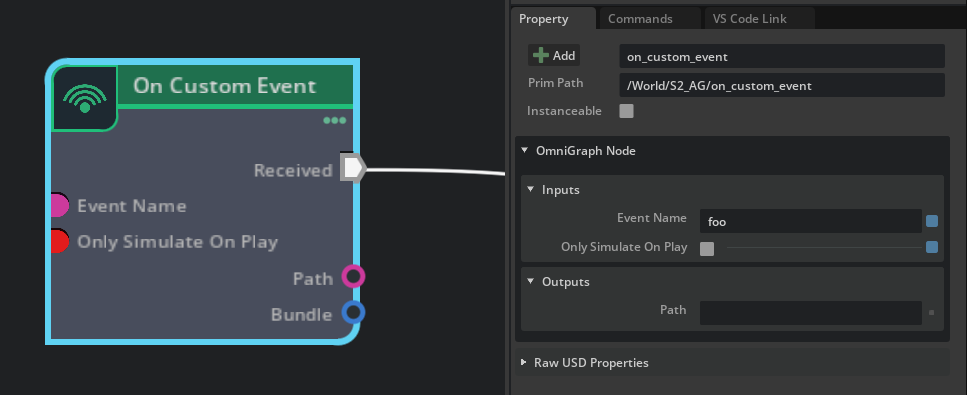

    # This links the Action Script to replicator
    # This will trigger an event in the Action Script named 'foo'
    # You have to create the action script, with the event in order for this to work.
    trigger = rep.trigger.on_frame(num_frames=10)
    publish_event_node = og.Controller().create_node('/Replicator/SDGPipeline/MyTest', 'omni.graph.action.SendCustomEvent')
    publish_event_node.get_attribute('inputs:eventName').set('foo')
    trigger.node.get_attribute("outputs:execOut").connect(publish_event_node.get_attribute("inputs:execIn"), True)

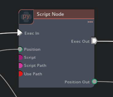

This rep script wires a trigger custom event node into the graph that gets generated. When the rep graph runs, it triggers the event in your custom action graph, where you can perform arbitrary logic.
Within your action graph, you can run logic as omnigraph nodes, or you can use python wrapped within a script node:
