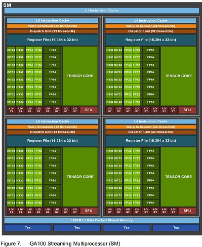

Hi, I noticed that in A100, each SMSP has 8 LD/ST units. How can it load 32 float in a cycle?
 ![image](https://global.discourse-cdn.com/nvidia/original/4X/2/8/4/2842f3e079f312d600d252a5aa1d47c50daeecb4.jpeg)
Also, I write a program of looping LDS instructions to measure the bandwidth of shared memory. The #block is set to 1 and #warp is set from 1 to 9. (#warp\>9 would pose an error.)

Compile it with `nvcc main.cu -gencode=arch=compute_80,code=\"sm_80,compute_80\"`. The SASS code is too long and I post a snippet below.

> [@qwerty00](#):
Can it?
> [@qwerty00](#):
> Why the “load operations per cycle” approximately increases by 0.25 as #warp increasing from 1 to 4?
This would indicate that you can only load/receive 8 float in a cycle per SMSP. This is independent of the shared memory to provide 32 float per cycle. The data is buffered/pipelined.
> [@qwerty00](#):
> Why #warp=5 and #warp=9 has a little drop in LDS bandwidth
The warps are unevenly distributed on SMSPs. So the resources of one SMSP are the bottleneck. Perhaps you would have preferred for those two warps to get only half of the loads instead.
