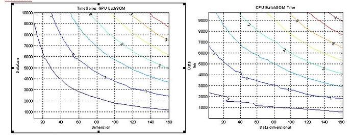

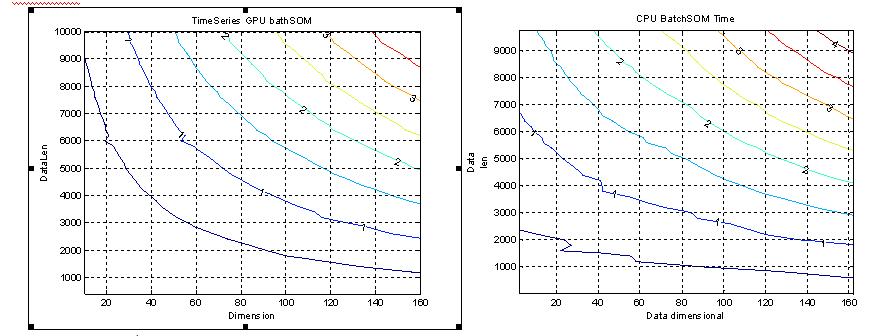

Bath SOM Parallel Algoritm for Matlab Src Matlab, Mex, C
If you need to Train large SOM, or you have a lot data Train, or you problem is high dimesional.

fig 1. batchSOM.jpg time diagram
left one Train SOM on CPU right on GPU 9600GT 10 SOM
