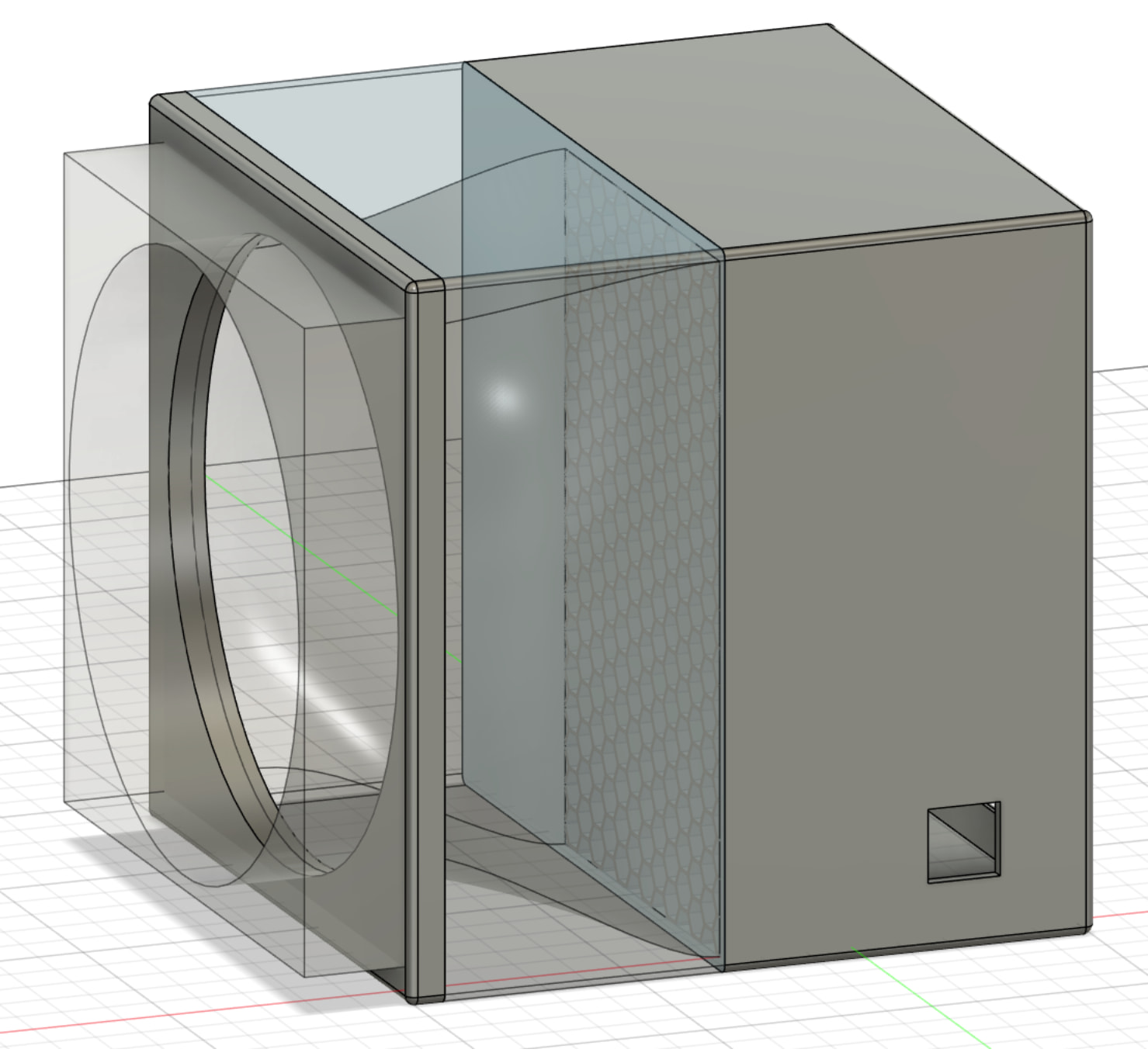

I have an unfinished design for the GX10 that would position it standing, with a plenum that’s supposed to be tightly connected to the air intake and with as much laminar flow as possible coming from a 140mm fan. It’s unfinished as I need to (a) add ~2mm of slack for the GX10 to slot in/out more easily; (b) carve out space for its stands, which I stupidly forgot to measure when I designed it; and (c) properly measure and add the screw inserts for the fans (I chose the Arctic P14 Pro PST for the design). It’s obviously untested too; I think this could work as a cooling solution as I should be making it quite easier for the blow fans to work.
This was my first foray into 3D design and I made a lot of mistakes, but I’m sharing it here in case it is interesting for anyone in the community.
Asus Ascent Stand - vF.zip (285.0 KB)
The real challenge is making it 3D printable with an every-day FDM printer – i.e. no overhangs less than 45 degrees in one orientation.
That’s my design forte – having had a heavily modded Makerbot Replicator since 2012, and its still running strong!
Start with the concept and think about how you can orientate and refactor it so it prints.
Also I shared models of all the GB10 units on GrabCad here
I don’t believe you can achieve laminar through a grill and squirrel cage fans.
In your particular case, I would make rails with 45 degree champhers underneath. Remove the overhanging faces altogether and use the case instead to make it printable from the fan mounting surface as the base. You also need to leave room for the feet so the unit can slide in, so if you make the back wall intersect the rear feet you wont need to plug those holes.
Single ASUS Pusher Duct.zip (32.9 KB)
Something like this will print without supports.

I added a slot to insert a 140mm fine mesh filter. I am still thinking about a power supply cooling solution.
Single ASUS Pusher Duct v2.zip (70.9 KB)

What about the fact that the intake is asymmetrical? It’s a rectangle that starts in the front plane but extends only about 10cm from it.
I’m not the correct guy for the job, but I figured that building a forced air solution to the GX10 would be an exercise in, let’s say, impedance matching.
I reasoned that putting a 140mm fan on top of a 150x100 intake, which itself hides two blow fans, could be a bad idea if my solution created pockets of trapped air that could slow down the flow instead. And this is without even adding the important consideration of having an air filter, which I completely ignored. And of course, whatever I did was just shooting from the hip with no real math applied to it.
It seems to me your exhaust solution is not only simpler/more elegant, but more guaranteed to work.

This is a good idea, and every design concept is worth exploring. There have been reports of GX10’s have experienced thermal shutdown issues. The internal fans seem to be focused on the main components, but there is a whole motherboard including memory, ssd and power regulation chips. I think some additional active cooling has merit, and there are only two real strategies to explore. Forcing more air in or out. The ASUS is a special case because the intake is so different from the others. Of all the units, the ASUS is the most amenable to forcing air in.
This design still needs to be printed and validated. I don’t have a GX10 – so I can’t help here. I would encourage you to keep iterating, developing in public, that’s how we hone our skills. ;)
