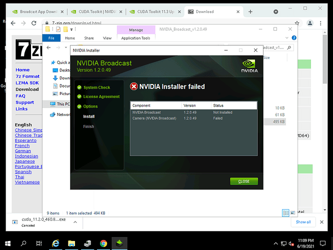

Windows 10 Pro with T4 GPU
the broadcast app won’t work
it won’t install
it neither installs with nvidia driver downloaded for tesla
nor it will install with cuda 11.3 installed driver;
While in the for,er case it would say that it requires a newer driver, in the latter case it pass this step but end up with error output further saying nothing was installed;
any way to use it?
Hi @Andrey1984
If you wish to try out the NVIDIA broadcast app, you need an RTX series card. T4, V100, and A100 fall are cards designed for datacenter applications.
For Maxine: Linux SDK is designed to work with the datacenter cards and the windows SDK is designed to work with the RTX cards. I hope this answers your questions

Broadcast app is a app runs on Windows 10 on PC, which also requires a RTX 20, or 30 series GPUs. It doesn’t work yet on virtual environment. Do you have RTX laptop by any chance?

Unfortunately so far the broadcast app doesn’t work well on the virtual desktops, I can share the feedback to the broadcast application product team.
