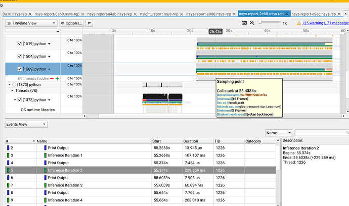

I’m using nsys-cli and I used all kind of options with numerous trials, but in the end, 1) I have Broken Backtraces as shown in the screenshot, and 2) couldn’t get “pt_main_thread”.
I’m using:
nvcr.io/nvidia/pytorch:24.09-py3
docker run -dit --gpus all --cap-add=SYS_ADMIN nvcr.io/nvidia/pytorch:24.09-py3
/workspace# ==nsys status -e==
Timestamp counter supported: No
CPU Profiling Environment Check
Root privilege: enabled
Linux Kernel Paranoid Level = 1
Linux Distribution = Ubuntu
Linux Kernel Version = 6.8.0-52-generic: OK
Linux perf_event_open syscall available: OK
Sampling trigger event available: OK
Intel(c) Last Branch Record support: Available
CPU Profiling Environment (process-tree): OK
CPU Profiling Environment (system-wide): OK
nsys profile -o report.nsys-rep --trace=cuda,nvtx,osrt,cudnn --sample=process-tree --cpuctxsw=process-tree --cuda-graph-trace=graph --backtrace=fp --python-backtrace=cuda python file.py
| NVIDIA-SMI 565.57.01 Driver Version: 565.57.01 CUDA Version: 12.7 |
| GPU Name Persistence-M | Bus-Id Disp.A | Volatile Uncorr. ECC |
| Fan Temp Perf Pwr:Usage/Cap | Memory-Usage | GPU-Util Compute M. |
| | | MIG M. |
| 0 NVIDIA GeForce RTX 3060 On | 00000000:00:08.0 Off | N/A |
| 0% 46C P8 17W / 170W | 2MiB / 12288MiB | 0% Default |
| | | N/A |
| Processes: |
| GPU GI CI PID Type Process name GPU Memory |
| ID ID Usage |
| No running processes found |
nsys-report-2e68.zip (13.2 MB)
I read all related posts, but couldn’t make it. Any help would be appreciated

@rknight could you please respond to this issue.
Hi skyblue46012,
Traditional IP sampling won’t work on a python process since it is jitting the executable. Try adding the --python-sampling=true switch to your nsys command line and remove the --sample=process-tree switch.
