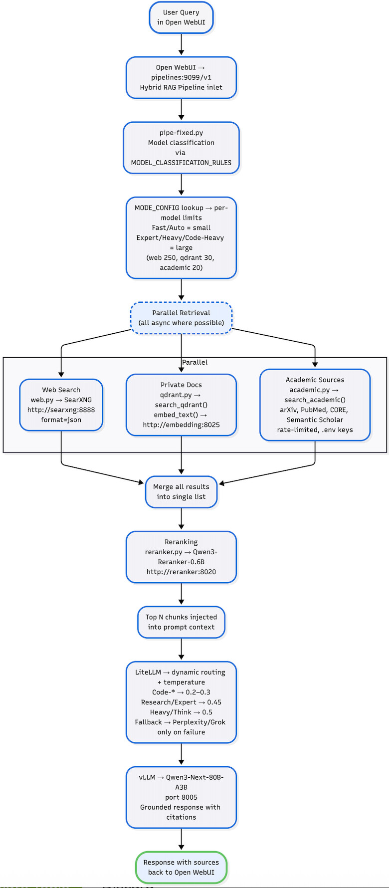

## 3. Routing and RAG Profiles
Open WebUI sends chat requests to `pipelines:9099/v1`, which calls `pipe-fixed.py`.[1]
- `pipe-fixed.py` extracts the user message, applies `MODEL_CLASSIFICATION_RULES`, and picks a RAG profile from `MODE_CONFIG`.[1]
- These limits are applied dynamically based on the selected model name in Open WebUI.
- The profile controls how deep the system goes into web, Qdrant, and academic retrieval and how many chunks are reranked.[1]
### 3.1 MODE\_CONFIG (Simplified)
| Profile | weblimit | qdrantlimit | academiclimit | reranktop |
| Fast | 5 | 10 | 5 | 10 |
| Auto (Standard) | 10 | 15 | 8 | 15 |
| Expert | 100 | 25 | 15 | 25 |
| Heavy / Moe | 250 | 30 | 20 | 30 |
| Think | 75 | 20 | 12 | 20 |
| Code‑Fast | 5 | 10 | 5 | 10 |
| Code‑Expert | 100 | 25 | 15 | 25 |
| Code‑Heavy | 250 | 30 | 20 | 30 |
Fast and Auto act as “light RAG”; Expert, Heavy, Moe, and Code‑Heavy go to full 250 web + 30 Qdrant + 20 academic depth.[1]
(Internally this is driven by simple rules such as “if model name matches `Code-.*` → use Code‑Heavy profile”, but I’ve kept the code out of the post for brevity.)
### 3.2 Parallel Retrieval
For each query, `pipe-fixed.py` launches three asynchronous retrievals:[1]
- `web.py` → SearXNG at `http://searxng:8888` (`format=json`, category “it” for code, “general” otherwise).
- `qdrant.py` → local Qdrant, using `embed_text()` via Qwen3‑Embedding‑0.6B at `http://embedding:8025`.
- `academic.py` → arXiv, PubMed, CORE, Semantic Scholar, OpenAlex (API keys, rate‑limits, multi‑hop expansion).
All results are merged into a single list of chunks for reranking.[1]
### 3.3 Reranking and Context Injection
- `reranker.py` sends the query + merged chunks to Qwen3‑Reranker‑0.6B at `http://reranker:8020`.[1]
- The reranker returns a list sorted by relevance score; I keep the top‑k (10–30, controlled by `reranktop`) and inject those chunks into the LLM prompt context.[1]
### 3.4 Generation and Fallbacks
- LiteLLM at `http://litellm:4000/v1` routes the request to the chosen model with the appropriate temperature and `max_tokens`.[2][1]
- The primary path is Qwen3‑Next‑80B‑A3B on vLLM (port 8005), which produces grounded answers with citations.[1]
- Responses go back to Open WebUI, including source references.[1]
Fallbacks to cloud models are reserved for exceptional cases—for example, timeouts, `max_tokens` limits, or explicit “use‑cloud” profiles—and are designed to keep cloud usage to a small fraction of total queries.

## 8. Prompt Flow Diagram
This diagram matches the current routing and RAG flow. Click Diagram to Enlarge:
 ![](https://global.discourse-cdn.com/nvidia/original/4X/2/0/f/20fc8f504f4c577bd89b74bc7ad0b183beb1141e.jpeg)
