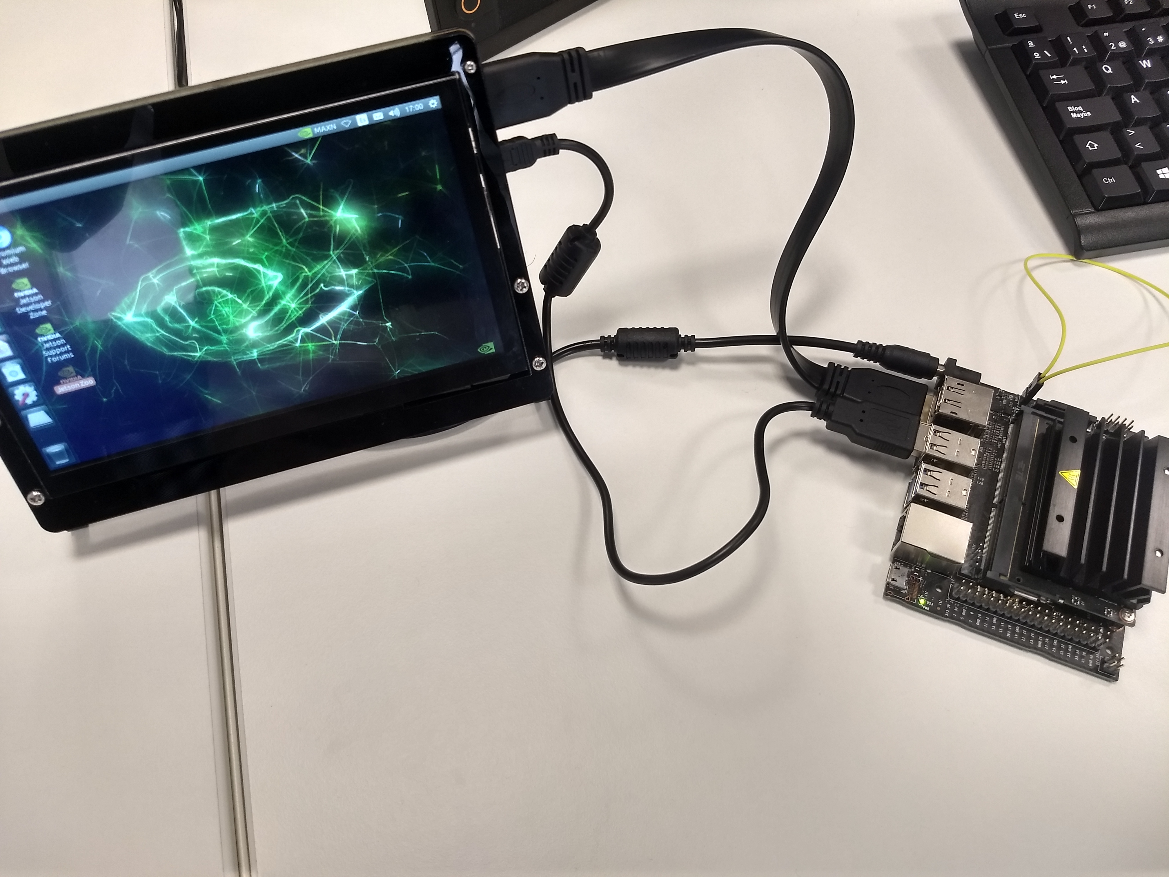

I had ByQDtech touchscreen working in Jetson Nano with Jetpack 4.2 without any problem. I have updated the Jetpack version to 4.3 and a problem happened. When I boot the system, the touchscreen starts working right but a couple of minutes later touch function doesn’t work. The jetson is not locked, if you connect a USB mouse, it works perfectly. I have updated to 4.4 and the same happens. With a Jetson TX2 I have the same problem.

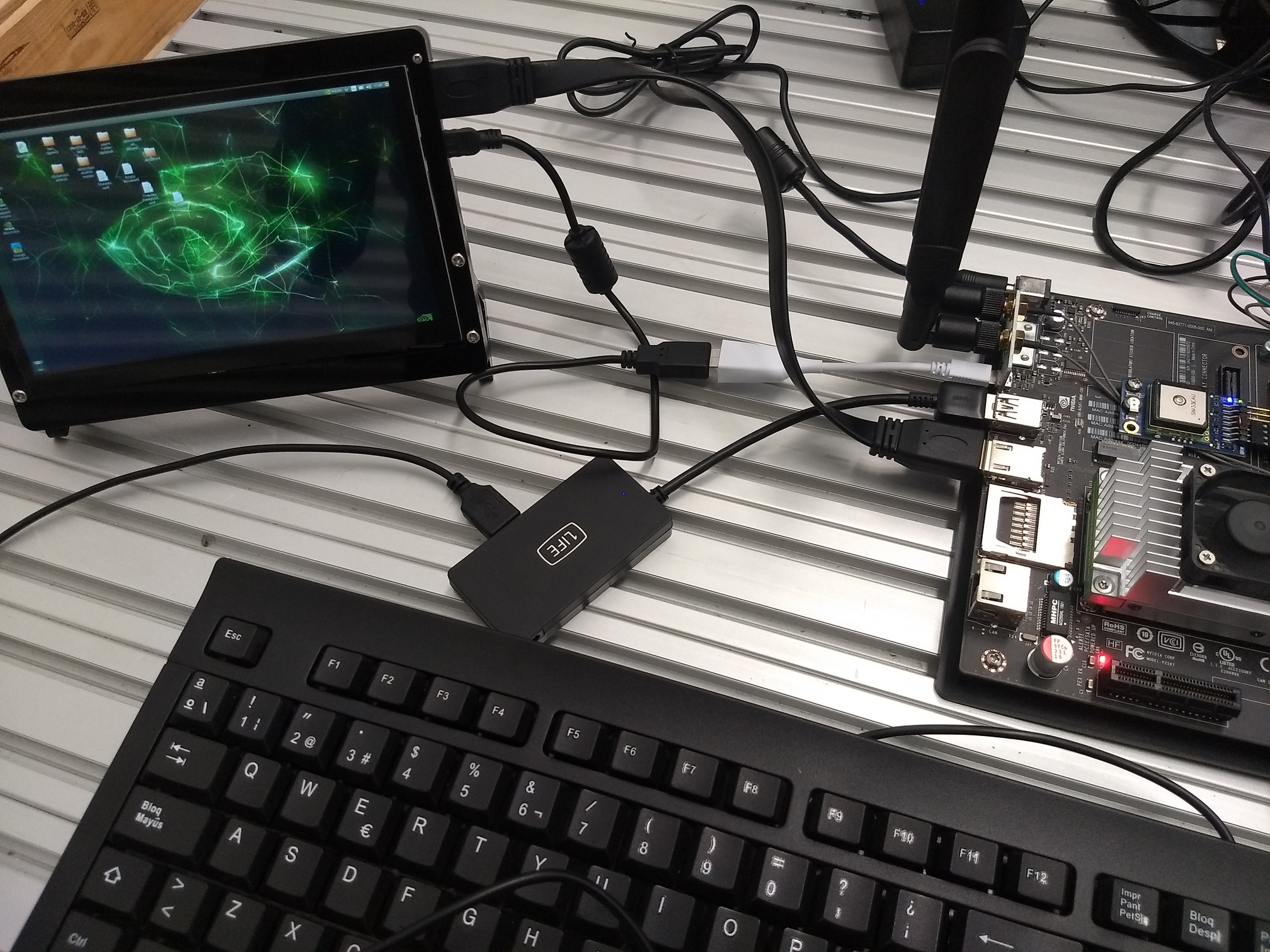

How long did you have to wait for this “suddenly it cant work anymore”? Also, could you share how do you connect this panel on Nano or TX2 devkit?
I have to wait between 1-2 minutes after power on. Please, attached you find a couple of picture where it is shown how the screen is connected to Nano and TX2.
On TX2, will it make difference if you plug the screen usb cable to the typeA port?
No, there is no difference. I did and the behaviour is the same.
