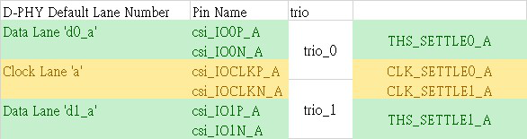

We want to adjust settle time for our C-PHY sensor.
In Xavier there are 2 data lane and 1 clk lane in each trio.
According to TRM NVCSI_PHY_0_NVCSI_CIL_A_CONTROL_0 can set settle time.
So is that means if we set THS_SETTLE0_A to 20, CLK_SETTLE0_A should be set to 20-7=13?
