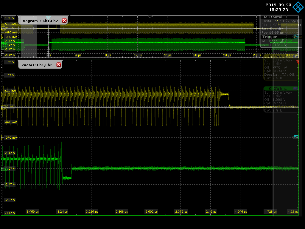

Camera 2 cannot get image
Hi, we are using Jetson Nano with RX(TP2854) to capture the images. We use TP2854 to connect Camera 1(0,1 port) and Camera 2(2,3 port). Camera 1 works normally, but camera 2 always gets timeout message. Did we miss anything or is there any other method we could try? We compared the MIPI signal waveform channel 0 and channel 1, and they are both similar.
The attachments are waveform images. The Yellow one is Channel 0, and the green one is Channel 1 for your information.
Version: L4T R32.2
Command: (Channel 0 works, but Channel 1 not work)
channel0: gst-launch-1.0 -v v4l2src device=/dev/video0 ! 'video/x-raw, format=(string)YUY2, width=(int)1920, height=(int)1080, framerate=(fraction)30/1' ! nvvidconv ! 'video/x-raw(memory:NVMM), format=(string)I420' ! nvoverlaysink
channel1: gst-launch-1.0 -v v4l2src device=/dev/video1 ! 'video/x-raw, format=(string)YUY2, width=(int)1920, height=(int)1080, framerate=(fraction)30/1' ! nvvidconv ! 'video/x-raw(memory:NVMM), format=(string)I420' ! nvoverlaysink
Here is dmesg for your reference.

[  172.275104] vi 54080000.vi: cil_settingtime was autocalculated
[  172.275108] vi 54080000.vi: csi clock settle time: 13, cil settle time: 10
[  172.476305] video4linux video1: frame start syncpt timeout! index:0
[  172.482918] video4linux video1: TEGRA_VI_CSI_ERROR_STATUS 0x00000000
[  172.482922] vi 54080000.vi: TEGRA_CSI_PIXEL_PARSER_STATUS 0x00000000
[  172.482926] vi 54080000.vi: TEGRA_CSI_CIL_STATUS 0x00000010
[  172.482930] vi 54080000.vi: TEGRA_CSI_CILX_STATUS 0x00040040
[  172.482981] vi 54080000.vi: cil_settingtime was autocalculated
[  172.482985] vi 54080000.vi: csi clock settle time: 13, cil settle time: 10
[  172.684292] video4linux video1: frame start syncpt timeout! index:0
[  172.691020] video4linux video1: TEGRA_VI_CSI_ERROR_STATUS 0x00000000
[  172.691025] vi 54080000.vi: TEGRA_CSI_PIXEL_PARSER_STATUS 0x00000000
[  172.691030] vi 54080000.vi: TEGRA_CSI_CIL_STATUS 0x00000010
[  172.691034] vi 54080000.vi: TEGRA_CSI_CILX_STATUS 0x00040040
[  172.691087] vi 54080000.vi: cil_settingtime was autocalculated
[  172.691091] vi 54080000.vi: csi clock settle time: 13, cil settle time: 10
[  172.892278] video4linux video1: frame start syncpt timeout! index:0
[  172.898889] video4linux video1: TEGRA_VI_CSI_ERROR_STATUS 0x00000000
[  172.898895] vi 54080000.vi: TEGRA_CSI_PIXEL_PARSER_STATUS 0x00000000
[  172.898899] vi 54080000.vi: TEGRA_CSI_CIL_STATUS 0x00000010
[  172.898903] vi 54080000.vi: TEGRA_CSI_CILX_STATUS 0x00040040
[  172.898955] vi 54080000.vi: cil_settingtime was autocalculated
[  172.898959] vi 54080000.vi: csi clock settle time: 13, cil settle time: 10
[  173.100261] video4linux video1: frame start syncpt timeout! index:0
[  173.106980] video4linux video1: TEGRA_VI_CSI_ERROR_STATUS 0x00000000
[  173.106985] vi 54080000.vi: TEGRA_CSI_PIXEL_PARSER_STATUS 0x00000000
[  173.106989] vi 54080000.vi: TEGRA_CSI_CIL_STATUS 0x00000010
[  173.106993] vi 54080000.vi: TEGRA_CSI_CILX_STATUS 0x00040040
[  173.107045] vi 54080000.vi: cil_settingtime was autocalculated
[  173.107049] vi 54080000.vi: csi clock settle time: 13, cil settle time: 10
[  173.308243] video4linux video1: frame start syncpt timeout! index:0
[  173.314847] video4linux video1: TEGRA_VI_CSI_ERROR_STATUS 0x00000000
[  173.314852] vi 54080000.vi: TEGRA_CSI_PIXEL_PARSER_STATUS 0x00000000
[  173.314856] vi 54080000.vi: TEGRA_CSI_CIL_STATUS 0x00000010
[  173.314860] vi 54080000.vi: TEGRA_CSI_CILX_STATUS 0x00040040
[  173.314911] vi 54080000.vi: cil_settingtime was autocalculated
[  173.314915] vi 54080000.vi: csi clock settle time: 13, cil settle time: 10
[  173.516186] video4linux video1: frame start syncpt timeout! index:0
[  173.522901] video4linux video1: TEGRA_VI_CSI_ERROR_STATUS 0x00000000
[  173.522907] vi 54080000.vi: TEGRA_CSI_PIXEL_PARSER_STATUS 0x00000000
[  173.522911] vi 54080000.vi: TEGRA_CSI_CIL_STATUS 0x00000010
[  173.522915] vi 54080000.vi: TEGRA_CSI_CILX_STATUS 0x00040040
[  173.522966] vi 54080000.vi: cil_settingtime was autocalculated
[  173.522970] vi 54080000.vi: csi clock settle time: 13, cil settle time: 10
[  173.724212] video4linux video1: frame start syncpt timeout! index:0
[  173.730813] video4linux video1: TEGRA_VI_CSI_ERROR_STATUS 0x00000000
[  173.730819] vi 54080000.vi: TEGRA_CSI_PIXEL_PARSER_STATUS 0x00000000
[  173.730823] vi 54080000.vi: TEGRA_CSI_CIL_STATUS 0x00000010
[  173.730827] vi 54080000.vi: TEGRA_CSI_CILX_STATUS 0x00040040
[  173.730878] vi 54080000.vi: cil_settingtime was autocalculated
[  173.730882] vi 54080000.vi: csi clock settle time: 13, cil settle time: 10
[  173.932200] video4linux video1: frame start syncpt timeout! index:0
[  173.938909] video4linux video1: TEGRA_VI_CSI_ERROR_STATUS 0x00000000
[  173.938914] vi 54080000.vi: TEGRA_CSI_PIXEL_PARSER_STATUS 0x00000000
[  173.938918] vi 54080000.vi: TEGRA_CSI_CIL_STATUS 0x00000010
[  173.938922] vi 54080000.vi: TEGRA_CSI_CILX_STATUS 0x00040040
[  173.938974] vi 54080000.vi: cil_settingtime was autocalculated
[  173.938978] vi 54080000.vi: csi clock settle time: 13, cil settle time: 10
[  174.140181] video4linux video1: frame start syncpt timeout! index:0
[  174.146781] video4linux video1: TEGRA_VI_CSI_ERROR_STATUS 0x00000000
[  174.146785] vi 54080000.vi: TEGRA_CSI_PIXEL_PARSER_STATUS 0x00000000
[  174.146790] vi 54080000.vi: TEGRA_CSI_CIL_STATUS 0x00000010
[  174.146794] vi 54080000.vi: TEGRA_CSI_CILX_STATUS 0x00040040
[  174.146846] vi 54080000.vi: cil_settingtime was autocalculated
[  174.146850] vi 54080000.vi: csi clock settle time: 13, cil settle time: 10
[  174.348134] video4linux video1: frame start syncpt timeout! index:0
[  174.354838] video4linux video1: TEGRA_VI_CSI_ERROR_STATUS 0x00000000
[  174.354843] vi 54080000.vi: TEGRA_CSI_PIXEL_PARSER_STATUS 0x00000000
[  174.354847] vi 54080000.vi: TEGRA_CSI_CIL_STATUS 0x00000010
[  174.354851] vi 54080000.vi: TEGRA_CSI_CILX_STATUS 0x00040040
[  174.354901] vi 54080000.vi: cil_settingtime was autocalculated
[  174.354905] vi 54080000.vi: csi clock settle time: 13, cil settle time: 10
[  174.556106] video4linux video1: frame start syncpt timeout! index:0
[  174.562707] video4linux video1: TEGRA_VI_CSI_ERROR_STATUS 0x00000000
[  174.562712] vi 54080000.vi: TEGRA_CSI_PIXEL_PARSER_STATUS 0x00000000
[  174.562716] vi 54080000.vi: TEGRA_CSI_CIL_STATUS 0x00000010
[  174.562720] vi 54080000.vi: TEGRA_CSI_CILX_STATUS 0x00040040
[  174.562772] vi 54080000.vi: cil_settingtime was autocalculateds
[  174.562776] vi 54080000.vi: csi clock settle time: 13, cil settle time: 10
[  174.764092] video4linux video1: frame start syncpt timeout! index:0
[  174.770791] video4linux video1: TEGRA_VI_CSI_ERROR_STATUS 0x00000000
[  174.770796] vi 54080000.vi: TEGRA_CSI_PIXEL_PARSER_STATUS 0x00000000
[  174.770800] vi 54080000.vi: TEGRA_CSI_CIL_STATUS 0x00000010
[  174.770804] vi 54080000.vi: TEGRA_CSI_CILX_STATUS 0x00040040
[  174.770856] vi 54080000.vi: cil_settingtime was autocalculated
[  174.770860] vi 54080000.vi: csi clock settle time: 13, cil settle time: 10
[  174.972078] video4linux video1: frame start syncpt timeout! index:0
[  174.978673] video4linux video1: TEGRA_VI_CSI_ERROR_STATUS 0x00000000
[  174.978678] vi 54080000.vi: TEGRA_CSI_PIXEL_PARSER_STATUS 0x00000000
[  174.978682] vi 54080000.vi: TEGRA_CSI_CIL_STATUS 0x00000010
[  174.978687] vi 54080000.vi: TEGRA_CSI_CILX_STATUS 0x00040040
[  174.978741] vi 54080000.vi: cil_settingtime was autocalculated
[  174.978745] vi 54080000.vi: csi clock settle time: 13, cil settle time: 10
[  174.979035] tp2854 6-0045: tp2854_write_reg: i2c write, 0x40 = 8
[  174.990626] tp2854 6-0045: tp2854_write_reg: i2c write, 0x23 = 2
[  174.997228] tp2854 6-0045: tp2854_write_reg: i2c write, 0x40 = 4
[  175.524795] tegra_mipi_cal 700e3000.mipical: tegra_mipi_bias_pad_disable
root@tegra-ubuntu:~#

hello roland6001,
just wondering it’s same situation as Topic 1063729, would like to have double confirmation.
did your testing procedure always launch 1st-camera(0x44) then you cannot receive 2nd-camera frame via camera(0x45)?
could you please restart the board, try to launch 2nd-camera(0x45) directly to avoid interference for testing.
thanks
Hi Jerry,
We did try to launch 2nd-camera via (0,1) port and it works, too. Currently, launching 1 camera is always workable via (0,1) port no matter 1st-Camera or 2nd-Camera. But (2,3) port is always NOT workable, even if we only connect 2nd camera still not works. We are confused how to make (2,3) port work.
Thanks a lot.
B.R.
Roland
hello roland6001,
it seems there’s control error according to the register error reporting,
please access Tegra X1 (SoC) Technical Reference Manual through Jetson Download Center,
you may check the register of CSI1_CSI_CILA_STATUS_0 for bit descriptions.
please also contact with your sensor vendor for further investigation.
thanks
Hi Jerry,
Actually we did some test already. It shows TP2854->port0/1 is OK and TP2854->port2/3 is NG. We used the same TP2854 to connect different port and got different results. We are trying to figure out what is happening. The attachment is for your reference. It shows our test result.
B.R.
Roland
hello roland6001,
hold-on,
according to the diagram, you’re connected TP2854 to CSI-E/F.
the code-snippet of the port-index setting from your device tree configuration was wrong.
you should set it to port-index=4
BTW,
how about connect your TP2854 to CSI-C/D for verification?
Hi Jerry,
We set it to port-index=4, and it works.
Thanks for your support.
B.R.
Roland
