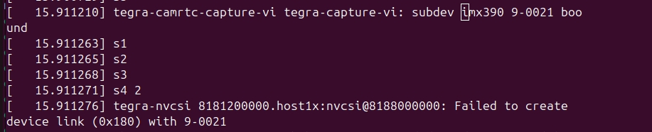

and I find some error report in kernel init as follow, is it the matter?:
“[ 13.935260] tegra-camrtc-capture-vi tegra-capture-vi: subdev imx390 9-0021 bound
[ 13.953401] tegra-nvcsi 8181200000.host1x:nvcsi@8188000000: Failed to create device link (0x180) with 9-0021

beside that, I add some trace in kernel to find why it can’t create link.
it seems the link is bounded from the trace, but i don’t know why.
