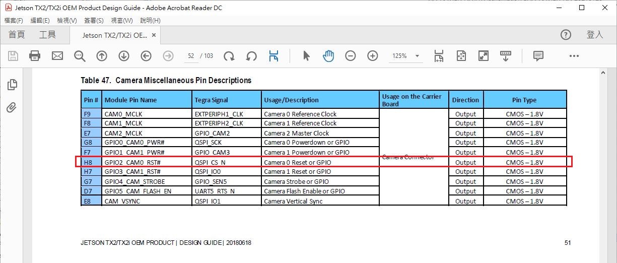

Camera reset pin is H8 or R5?
I see the reset-gpio is TEGRA_MAIN_GPIO(R, 5) in device tree:
reset-gpios = <&tegra_main_gpio TEGRA_MAIN_GPIO(R, 5) GPIO_ACTIVE_LOW>;
In sensor driver programming guide, I see the camera reset pin is R5 :
https://docs.nvidia.com/jetson/archives/l4t-archived/l4t-283/index.html#page/Tegra%2520Linux%2520Driver%2520Package%2520Development%2520Guide%2Fcamera_sensor_prog.html
But I see the GPIO2_CAM0_RST# pin is H8 in the JetsonTX2_TX2i_OEM_Product_Design_Guide_20180618.pdf :
So how to mapping camera reset pin to TX2 module? is H8? is R5?
Please refer to pinmux sheet in DLC. TEGRA_MAIN_GPIO(R, 5) means GPIO3_PR.05 not pin R5 as listed in sheet which is mapped to pin H8.
OK, I got it and thank you.
