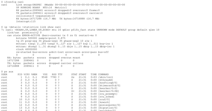

I’m seeing a problem when running CAN bus for a few hours, the transmit stops working and no errors in the statistics are indicated. I was able to repro the issue using canfdtest which is part of can-utils, so this excludes any of our application code. I also tested using PEAK USB-CAN X6 and same problem occurs.
I’m using AutoChauffeur running 5.0.5.0b. I have CAN_5 looped to CAN_6 with 120 ohm termination between them.

After some random time, I’ve seen 10 min to 5 hrs, the test gets stuck and ifconfig counters show nothing happening. Typically the CAN which is configured as “listener” (without the -g) is the one stuck and process shows 100% CPU utilization. I can’t kill it with Ctrl-C, only a kill -9.

seems we only reproduce CAN bus stops working issue here,
receiver side stuck there and cannot waiting for expect packet.

The error message “Databyte X mismatch” is the out of order issue. When stuck error occurs, there is NO error messages on either terminal.
From my testing, it seems out of order issue happens about twice as frequently as stuck issue. The canfdtest quits as soon as it detects any errors, so it’s harder to find the stuck issue.

hello gordon1zrra,
could you please try to reproduce this issue again with the patch in the attachment,
this has configuration to use only buffer mode for Tx and only fifo mode for Rx side.

After running over the weekend (about 60hrs) it looks like the stuck issue is fixed. I still see the out of order message issue but for us this isn’t critical since our application can deal with out of sequence messages.

hello gordon1zrra,
we are planning to move to FIFO only mode for both TX and RX.

Hi JerryChang,
I ran the CAN test for over 140 hrs and I didn’t see any problems. The change also fixed the out of order issue.
