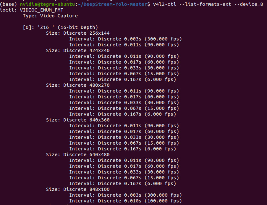

Yes,it integrates a depth camera inside. And I am thinking that if I don’t use the camera API, can I also get the depth images just by using deepstream code?
No. The depth camera can’t output standard video formats. You must use the camera vendors’ API.

I used to check the source of my camera and for depth camera:
So, if my input source is a RGBA camera,then the depth images can’t be created by deepstream codes,right?
You are right. DeepStream is based on GStreamer: open source multimedia framework . There is no depth color format in GStreamer: open source multimedia framework . So DeepStream uses another way to introduce depth color format into DeepStream. DeepStream 3D Depth Camera App — DeepStream documentation (nvidia.com)
