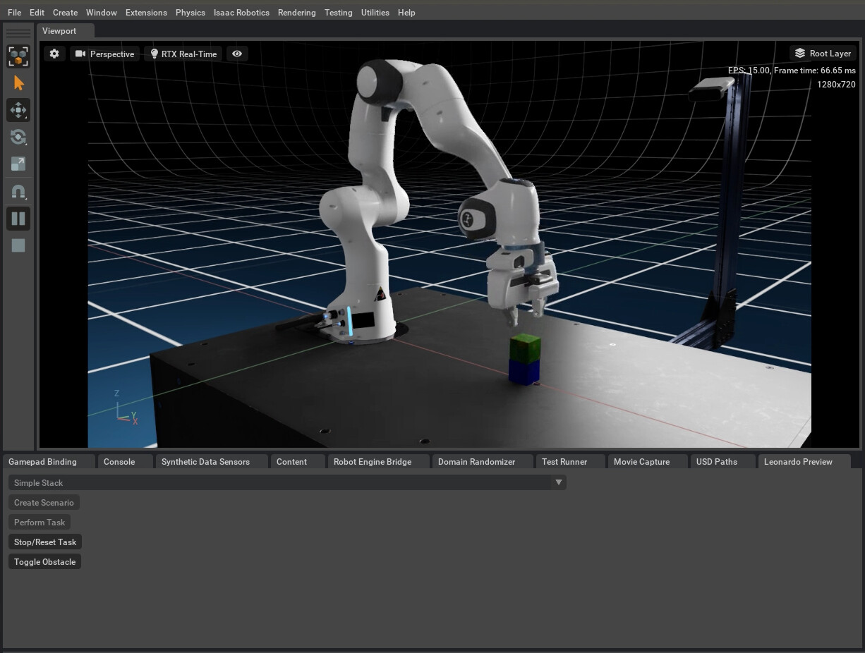

I tried running Leonardo Preview sample (Simple Stack), but FPS is only 15.
