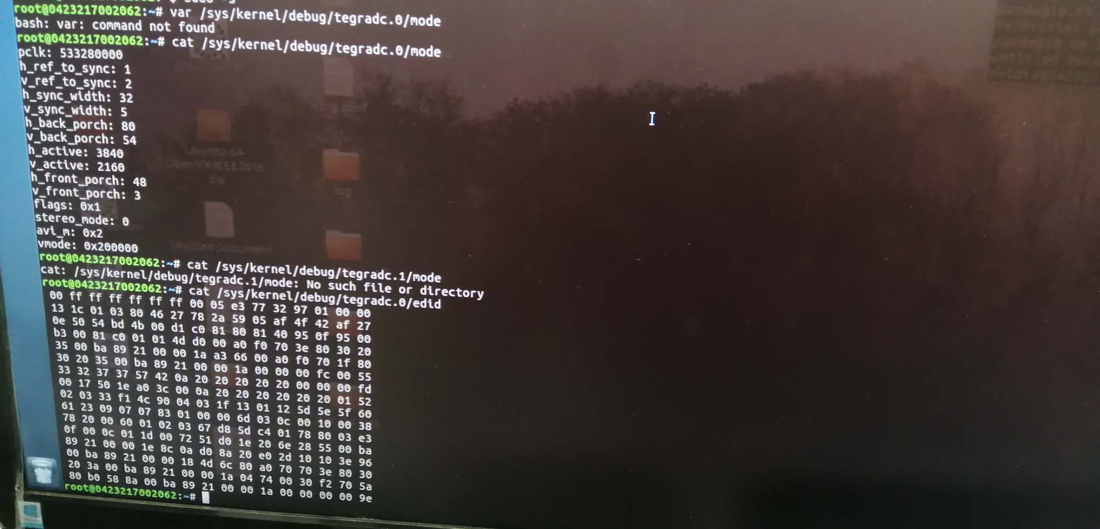

Sorry, it should be tegradc.1/mode. Could you share it?
HI Wayne,
no this file.

Do you connect HDMI monitor when you try to dump tegradc.0/mode??
Hi Wayne,
no, currently I connect TX1 with a desktop with Ubntu system.
must connect HDMI monitor?? if yes I will do it.
Yes… this step is to check the detail of your monitor mode from tegra side.

pls check ~
Could you attach it as a text file to me? dmesg is really long. Your jpeg also does not cover all of it.
Also, the mode is still in 1080p mode. What I want to know is the 4k mode.
