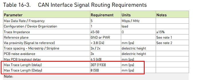

HI NV:
What does this item in the design guide mean ?
It means the max length of trace line…
What’s the difference between these two
The last row is typo, should be “Max Trace Length/Delay Skew from RX to TX”. Thanks for the note, will inform team to correct it.
