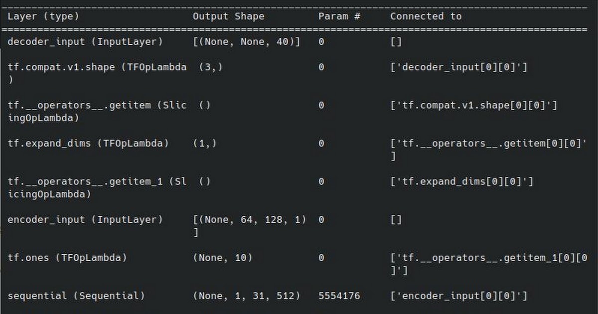

Cannot broadcast shapes that have different ranks (onnx=>tensorrt)
Description
I have SavedModel format of a Tensorflow2 model and I follow the guide: https://developer.nvidia.com/blog/speeding-up-deep-learning-inference-using-tensorflow-onnx-and-tensorrt/
When I try to build engine (from onnx to tensorrt), I get the error from parser:
In node 66 (isBroadcastValid): UNSUPPORTED_NODE: Cannot broadcast shapes that have different ranks!
I also try it with trtexec, but the result is same.
Any help is appreciated.

summary of the model:
savedmodel:

Request you to share the ONNX model and the script if not shared already so that we can assist you better.
Alongside you can try few things:
  1. validating your model with the below snippet
check_model.py
import sys
import onnx
filename = yourONNXmodel
model = onnx.load(filename)
onnx.checker.check_model(model).
2) Try running your model with trtexec command.
In case you are still facing issue, request you to share the trtexec “”–verbose"" log for further debugging
I attached onnx and saved-model.
in the mean time, check_model does not throw any error.
output of --verbose:
https://drive.google.com/drive/folders/1vMhIVxgkmdeTMR_KbLntA9yk5b9qauiY?usp=sharing
Thanks in advance
Hi @dogu.budak ,
Apologies for the delay, are you still facing the issue?
Yes, I am still facing the issue
