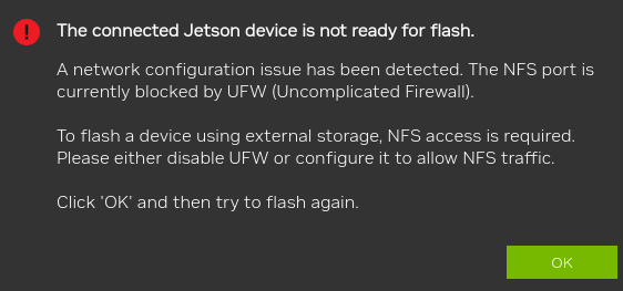

I am trying to flash to Jetpack 6.2.1 with my host computer with Ubuntu 22.04.
When I try to flash to the hardware I get this error and can’t continue with the flashing process.
I’ve already flashed my jetson with the same computer, but now I can’t.
I’ve tried disabling the ufw firewall on the jetson but didn’t help. Also allowing nfs access to my host pc IP, but with no success.
It’s the first time I am facing this issue.
I tried with another host PC and it could flash it with no problem. So this makes me believe maybe there is something wrong my host PC. Is there any way to determine what is causing this issue?

From the looks of it, seems like your firewall is messing with you.
Can you try disabling it with:
sudo ufw disable
And re-trying the flash?

Hello @proventusnova,
Yes! I was disabling the firewall in my jetson instead of my host computer.
I just tried disabling it in my host computer and the flashing process worked as expected!
