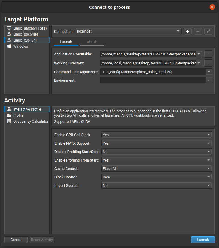

I am trying to launch a CUDA app. I could use Visual Profile on GTX 1050. Now I need to run it using GTX 3090 and use Nsight Compute. I see following errors:
I am attaching screen shots of configurations. I am trying to launch using Interactive profile and Profile in the connection setting.
Error_Interactive

Thanks @felix_dt ,
Here is my driver version:Driver Version: 470.86;
I found error that in the arguments I typed a file name which is not in the directory.
I fixed it by entering a file name (ending with cgf) into the working directory.
